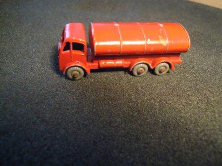

Yes Hugh, I can confirm this variation.Idris wrote: Variation 11-2D appears to be a GPW r/a model with the oblong hole at the rear and no side-tank trim but without the cab-to-tank brace. If proven (and it is plausible), this would become the new Nick Jones variation code 8a. U.K. .
- DSCN6024.JPG (28.68 KiB) Viewed 3598 times
- DSCN6025.JPG (31.41 KiB) Viewed 3598 times

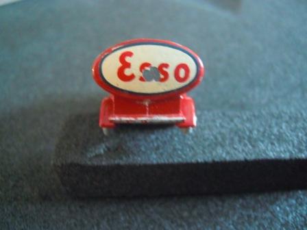

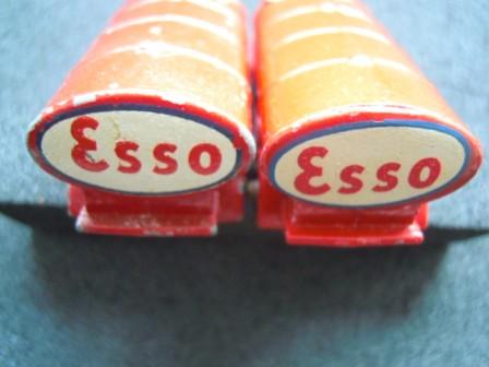

Yes, there is slight difference in the decal dark blue/ blue surround.Idris wrote: Variation code 11-2J (r/a, round hole, cab-to-tank brace, no side-tank trim, GPW) is noted as having a decal with a blue rather than a dark blue surround. Can anyone confirm the existence of a significant colour difference on the decal?
- DSCN6026.JPG (20.71 KiB) Viewed 3597 times

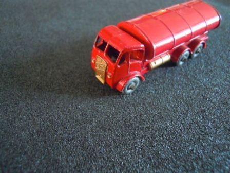

Pretty rare variation with gold trim, but with dome head crimped axles
- DSCN6027.JPG (33.13 KiB) Viewed 3597 times

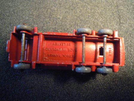

one unlisted variation with MS rear silver trim
- DSCN6028.JPG (18.54 KiB) Viewed 3597 times

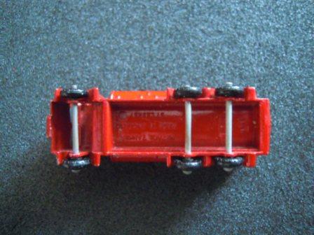

Another unlisted variation with BPW ø8x18, MS silver trim applied to grill and headlights only, 2,5mm wide cross brace, with closed oblong and round hole
- DSCN6029.JPG (32.48 KiB) Viewed 3597 times

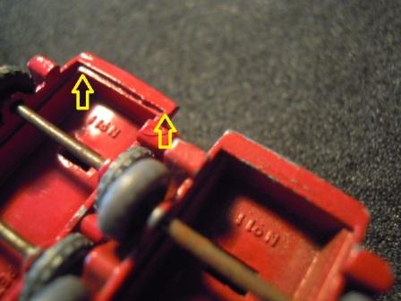

And another unlisted variation:
a) rear brace with step
b) rear brace without step
- DSCN6030.JPG (23.75 KiB) Viewed 3596 times
Re: 11b ERF Road Tanker
I think that in Stannard´s list ist a mistake. There is mentioned a variation with SPW ø8x18. In my opinion, the SPW ø8x18 never existed.
That might well be Leake's 'ridge' variationDiecast wrote:And another unlisted variation:
