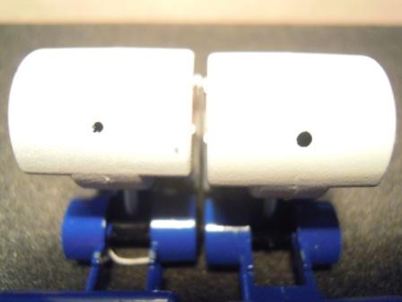

Re: 15c Tippax Refuse Truck
Yes Hugh, there are two different diameters of peep hole. The peep hole is smaller by early models.Idris wrote: Leake ('Catalogue of 75 Series Matchbox Toys by Lesney" (4th edition, reprinted 2006)) notes that two different diameters of peep hole exist. Can anyone confirm? If Leake is correct, is this once again simply a paired tooling difference?
U.K. Matchbox did not examine the model.

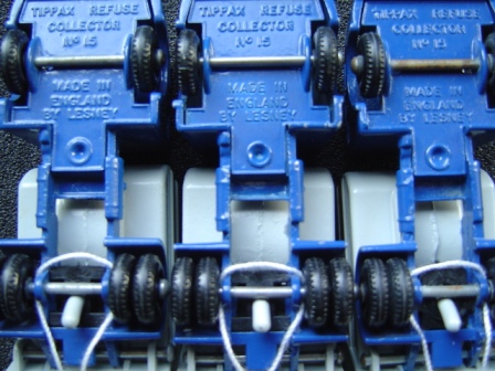

There are some unlisted chassis (I have mentioned it yet)
- DSC00113.JPG (82.11 KiB) Viewed 2979 times
- DSC00114.JPG (76.47 KiB) Viewed 2979 times
- DSC00115.JPG (81.66 KiB) Viewed 2979 times
- DSC00116.JPG (84.82 KiB) Viewed 2979 times

I always check Leake but, because his coverage of variations is very high-level, only report my findings if he either supports the existence of an unlisted variation already identified from one of the other catalogues or, as in this case, appears to have spotted something completely new.Diecast wrote:Yes Hugh, there are two different diameters of peep hole. The peep hole is smaller by early models.Idris wrote: Leake ('Catalogue of 75 Series Matchbox Toys by Lesney" (4th edition, reprinted 2006)) notes that two different diameters of peep hole exist. Can anyone confirm? If Leake is correct, is this once again simply a paired tooling difference?

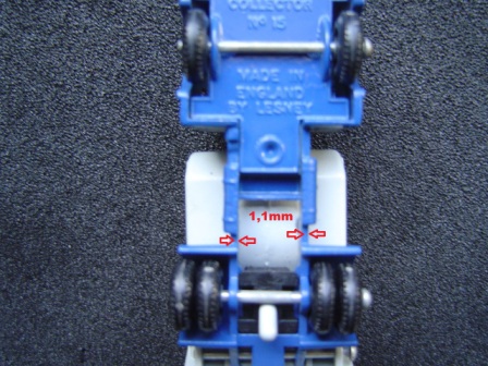

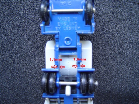

hey George...im happy to say...i found a tipper with the thin hinge brace
one thing i noticed...one side is wider than the other...as in your pics #1 and #2...are those two pic of the same model or two different ones...because mine has both of those types
also my model has painted grill...hole and fine tread wheels and the later longer supports at the rear wheels...ill get pics this weekend
Hello Dan, no all the pictures are of different models. and one of my models is the same as your one FBW Silver trim
and different size braces on the hinges.
