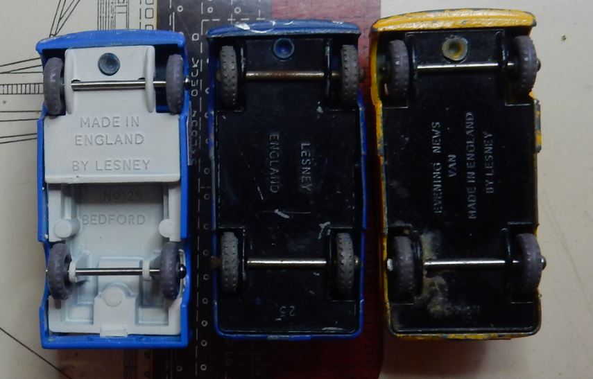

radar wrote:Are many 1-75 base plates identical or interchangeable?I guess the Commer Dunlop van, Evening news and Milk van maybe are.
No they are not identical or interchangeable.
And they are Bedford baseplates.:-)
Isn't that odd?
