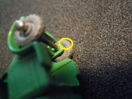

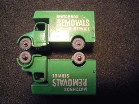

I can confirm the existence of a model 17a with MW ø8,5mm and ø9mm. The metal wheels ø8,5mm are unnumbered and MW ø9mm have the Nr. "17" (according precise measurement MW ø9,0x18 have ø8,71 - 8,90mm).Idris wrote:One question: As with 17b, Nick's listing has both 8.5 and 9 mm diameter MW. Do these actually reflect numbered and unnumbered wheels respectively?

Re: 17a Removals Van
Thanks for checking and for the pictures George! Out of curiosity, does this (smaller size) apply to just the one wheel or to all four wheels on your model? In your picture it seems as if the other three wheels are larger, but I am not sure about this.kerbside wrote:! have an 8.5 metal wheel with the #17 cast on it, the only trouble is it is on a 17b model. I have 7 17a models but none have the # 17 cast on the wheels.
If there are indeed smaller wheels with #17 cast, then IMHO these should constitute additional variations, perhaps for both 17a and 17b, notwithstanding the probability of wheel mixes.
