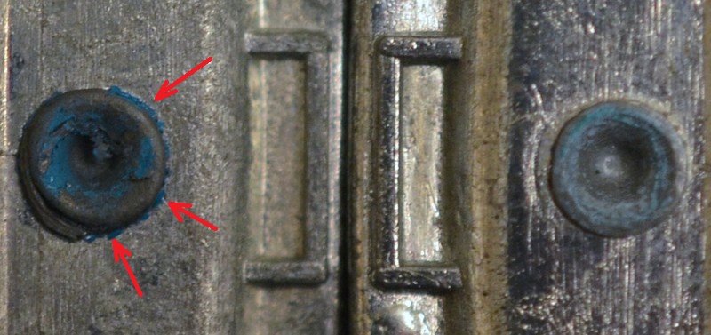

Rivets, we love our rivets on this forum don't we... :D , I must confess as soon as I saw those on your Studebaker, they are saying something to me and initially they look fine, but for me the flare-over on each rivet seems to be far too flat against the surrounding baseplate area, can you do another side by side picture of the Two Studes baseplates, so we can see known factory finish rivets against the mystery model, thank's.

Kevin, here are the front rivets for comparison:
Here are the rear:

When we discussed this model at some length on Lefora, one of the things which came out was the use of two-coat paints on later issues. (This was proposed as the reason why many Studebaker Larks are so difficult to photograph correctly.)
When I saw thus particular example listed, my assumption was therefore that it is a model which has received only the first coat of paint. I would therefore suggest trying comparing the colour to that showing through on the chips on any playworn examples you may have.

I agree with Hugh on the colour issue, that could be quite revealing but now I have seen both cars rivets, I am convinced the model does not have factory finish rivets. The front rivet shows indentations around the flare more than the rear rivet does, but more revealing is there are no paint shavings squashed between the underside of the flare and the baseplate immediately under the flare highlighted on the picture below.
Front rivets.jpg (163.09 KiB) Viewed 883 times
What is highlighted in Red is perfectly normal factory finish and the result of the rivet's shaft being a close fit into the baseplate's hole causing the scraping of paint and then bunching up of this paint to become trapped under the rivet's flare when the rivet is pressed or spun down to the baseplate. This is very difficult to fake and this is what I don't see on the mystery Studebaker for both rivets.
