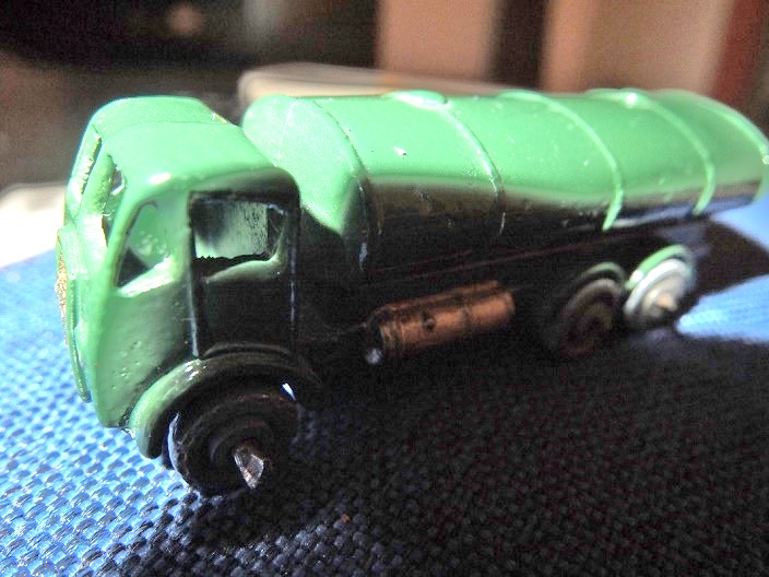

Did I waste my money on this? I can show close ups of any bit if we get that far!!!

My initial reaction is that it is probably not genuine (colour looks to be off, green paint appears to be on top of chips, crimps do not look correct, very sloppy trim painting on fuel tank).
Any chance of a photograph of the underside?

Posted: Tue Oct 04, 2016 8:48 am
Any chance of a more general shot showing the whole of the underneath?

not the best photography!

damn shadow :oops:

Without seeing it in the hand, it’s difficult to be 100% certain but, given that the colour looks not quite right plus the nature of the axle crimps, I would suggest that this is a repaint. However, I could easily be wrong, so what do other Members think?

I went directly to the axle crimps and thought they do not show a typical Lesney finish and why is the extreme rear axle so short the body seems to be squeezed inwards for it to reach across the body.
Here is the last image with highlights.
DSCF6683 highlight in shadow image..jpg (94.64 KiB) Viewed 1192 times

Hello Brainstrust, It is a repaint as it is not the correct casting, the base bit behind the front wheels should be flat. But looking at your photo
this bit on yours has a round piece added to it. As this photo shows of mine.
Re: Green 11a?
Posted: Tue Oct 04, 2016 4:07 pm
George is refering to the strenthening brace which was added to the underside of the metal area directly connecting the bottom of the cab to the tanker chassis.
The Green model in George's picture is flat at this area with the Red model having the additonal 'Brace' casting.
