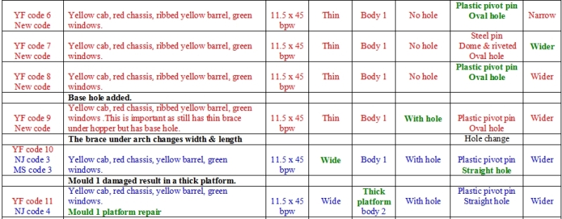

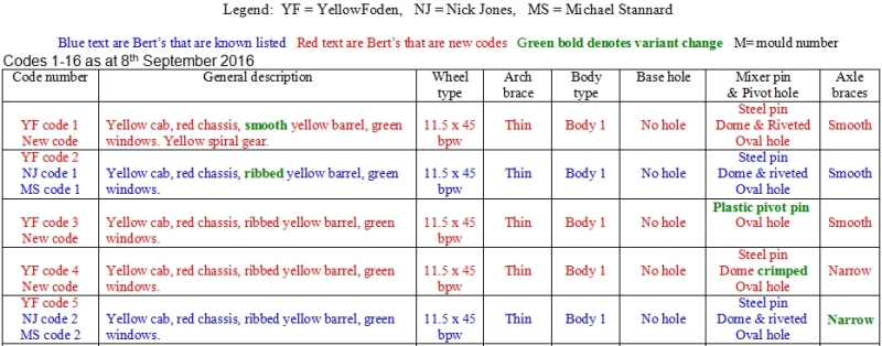

There are five significant unlisted variations I have discovered which expands the variation table by 10 or so new variations to 16.

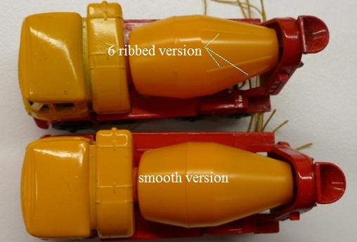

The first is the plastic barrel without six rib lines.

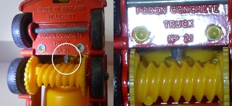

The second is the crimping of the steel barrel pin instead of riveted or rounded over at spiral gear end.

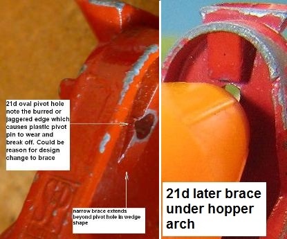

The third is the width and length of the brace under the hopper arch. This casting change to date has not been documented in any of the 6 major variation catalogues but gives rise to multiple new variation combinations.

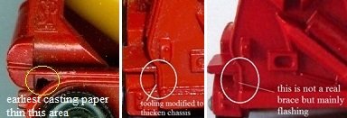

The fourth is the sizes of the rear brace under the platform as a result of one die being damaged and on being repaired gave rise to two different size rear braces. Only one of the rear braced models has been listed by Stannard, Houghton and Nick.

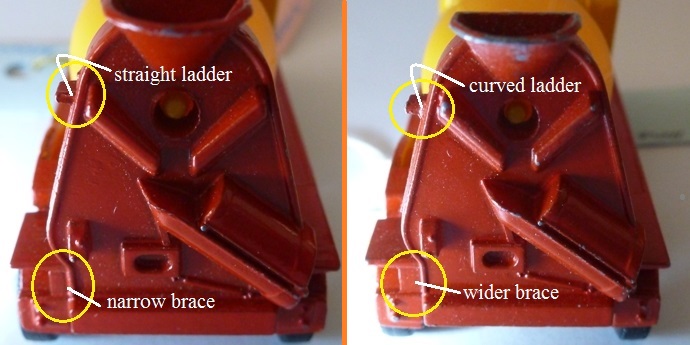

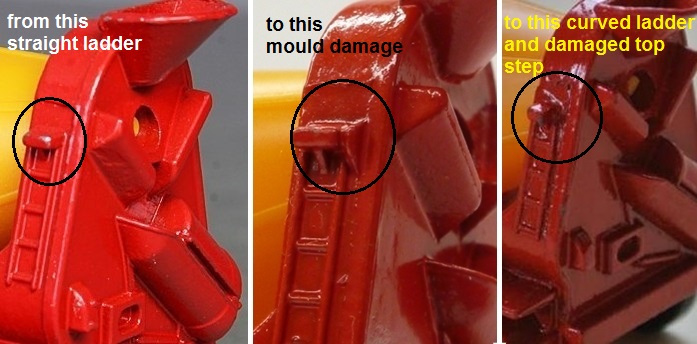

The fifth is the interim damage to mould or die of top of ladder where castings were being made prior to tooling being repaired. See attached photos.

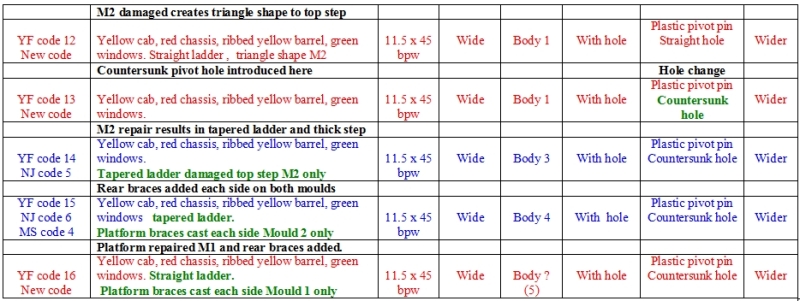

The following table documents the changes. I have added a bit of colour to highlight the changes that took place with this model. New unlisted codes are in red.
I also have other examples that shows varying degree of repair of ladder damage, but I have not included these in the attached table.
Because these dies were damaged models have been found where excess flashing can be mistaken for rear braces. These are also not included in the variation table.
In addition to those mentioned, single examples of a unique lemon colour cab ( Mike) similar in colour to 33c Miura and another with an orange body ( Jason - nearlymint) with a good match to the 30c crane jib colour have been shown elsewhere on the forum. Second examples of these are being hunted for.
There may be a couple of variations that exist in other collections however I have only based the table on those models I have in my own collection.
Thanks to kwakers, kerbside and nearlymint for taking an interest and verifying second examples over the years of some hard to find variations.
Hope this helps make members and Nick’s job easier in the event of any updates.
Bert

- 1. 21d smooth and ribbed barrell comparison.JPG (58.92 KiB) Viewed 1164 times
- all models found in USA so far
- 2. 21d crimped barrel examples.jpg (168.25 KiB) Viewed 1164 times
- Unlisted early major casting change
- 3.21d thin brace and wide brace differences.jpg (63.64 KiB) Viewed 1164 times
- why the rear braces came about
- 4.section under platform was very thin early.jpg (27.54 KiB) Viewed 1164 times

- 5. 21d rear braces.jpg (91.52 KiB) Viewed 1164 times
- how the curved ladder came about
- 6 from straight ladder to curved ladder.jpg (87.5 KiB) Viewed 1164 times
- page 1 codes 1 - 5
- 7 bert codes 1-5.jpg (197.3 KiB) Viewed 1164 times
- page 2 codes 6 - 11
- 8 bert codes 6-11.jpg (196.03 KiB) Viewed 1164 times
- page 3 codes 12 - 16
- 9 bert codes 12-16.jpg (202.32 KiB) Viewed 1164 times

This is a long awaited pleasure to see here Bert! I can now modify my "Bible" on this model that we have worked hard to update and sort out over the last couple of years. The results are really impressive when charted in stages of casting changes as you have. I can't believe the steel pin shows up in some of your later variants as it has, I better look a lot closer at these now. That smooth barrel is a rare beauty I will have to watch out for over here now, what a find...... Cheers! Kwakers
