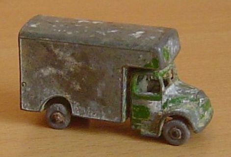

Not to long ago, I acquired this rather worn 17b, in a group lot . Considering it's sad state and poor condition, I thought it would make for a good choice for a first attempt.. Thinking that I couldn't make it much worse and at the very least figured I could make it look better, than it did when I started.
As one can see from the photo, this 17b has seen better days. From what I can tell, it was originally the more rare, dark green version of the 17b, with grey plastic wheels. Now most it's paint gone and the casting is heavily corroded with white rust. The wheels were frozen solid on the axles and would not, turn. In fact the axles themselves were so heavily rusted they would not turn either. In addition it had a pretty good dent in the side above rear wheel arch on the right hand side.

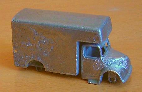

This pic is after the vinegar soak and removal of the wheels and axles. Using a small C-clamp and following up with a bit of hammer and dolly work, I was able to get the dent out from above the rear wheel arch. The vinegar soak actually removed what was left of the original dark green paint. One can see that white rust had really attacked the casting. Most of the fine detail from the original casting has been wiped out.

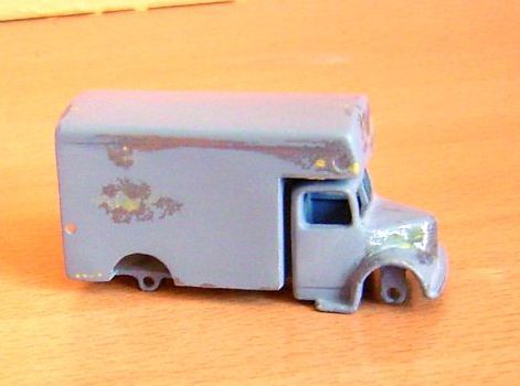

This photo is after a few primer/filler coats, sanding in between coats. Things are beginning to smooth out on the casting and its coming along. Putting the detail back is going to be a challenge though.

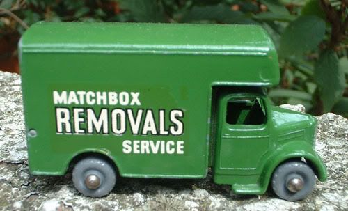

As you also suggested, I have have been using a nice clear photo of a 17b (shown below) which I found on Nicks site as a guide.
One can see from this photo the detail, that has to be put back in. There are casting lines around the box and over the rear wheel arches, as well as on the door and below the bonnet and then of course there will be the grill to redo. Some of these details are very small and I'm finding that I really need to get a magnifier as the old eyes ain't what they used to be. Making slow progress, but progress non the less. I will post some more photos as I get a it further along with things.
