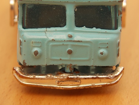

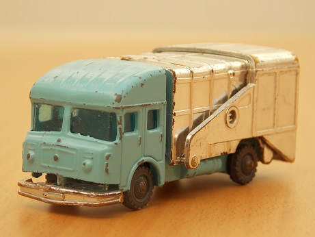

While progress with the Guy is slow (whatever I said in a post about me having lots of time on my hands - forget it) I can be getting on with an altogether much simpler project. At a recent jumble sale I picked up Husky's Shelvoke & Drewry Refuse Van, which is in acceptable condition save for the fact that the front rivet that holds the base to the body has been lost, resulting in the unfortunate, slack-jawed gaping expression that you see in the pictures. I'd like to remedy this but don't have a clue what glue to use. Obviously, I don't want to melt the plastic or use something that will be visible and potentially damaging if removed, and I also want something that'll work effectively. You'll have to forgive me asking for help on what must be some of the most basic problems, but please treat me as someone who has never had the opportunity to learn anything like this before.

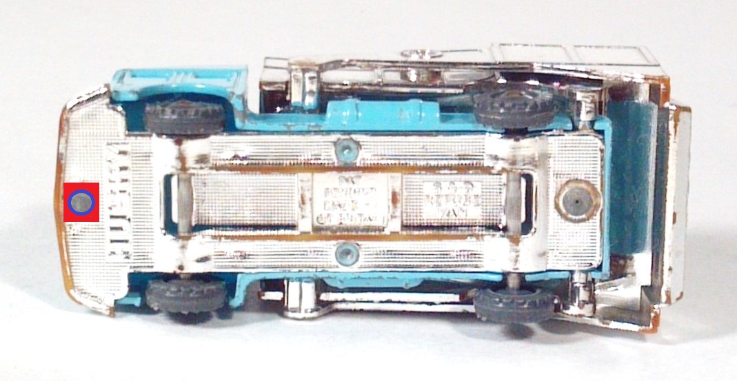

Scrape away thee Silver plating on the base around the rivet, find a piece of tubing that looks as if it will just slide over the remains of the rivet, such as that found on electrical wire (the outer insulation), and slide it on to the rivet. This can be just a tight fit, allowing it to be removed at a later date should you wish to restore the model completely, or use 'Superglue' to stick this little homemade sleeve on the rivet and to the prepaired base.
The Red area is the scraped away silver plating to expose the plastic underneath. The Blue area is you little home made sleeve, placed on the remains of the rivet and its your choice to fix this with 'Superglue'.
If there is not enough rivet showing through the baseplate hole, carefully scrape away the Silver plating behind the front bumper where it contacts the metal lower front edge of the body and I would also carefully scrape away the Blue body paint to give a good fixing contact for the glue (Superglue).
