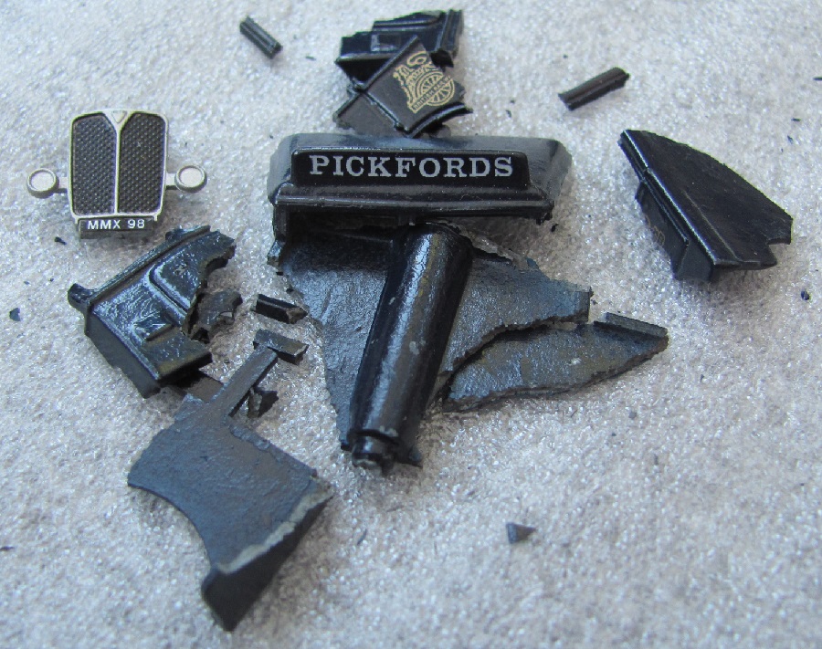

Whilst rummaging in the loft I came across this sad looking EFE artic. The metal floor of the trailer has expanded due to the dreaded mazak pest (heat maybe?). The force has even prised the cab off its rivet. I think I may be able to salvage it as a rigid, or failing that, a grounded body maybe. Proof I think that lofts aren't the best place for model storage.
Strange though that no other EFE models or plastic model kits haven't been damaged up there but I store everything in the garage now to be on the safe side.

I think it is more likely that the plastic has shrunk, but thanks for posting this, you might just stop others making the same mistake and ruining their toys.

Looking for some 1:76 scale wheels for another project, I sifted the above model from my parts box. I don't think it is anything to do with loft storage now, as the plastic parts that would be be more susceptible to the heat are undamaged. It is definitely mazak fatigue.
Studying closer, the mazak trailer bed had grown lengthways by almost an inch. It hadn't grown widthways at all. All the mazak parts could also be snapped with less force that snapping a biscuit. Even the thicker chassis parts could be crushed by hand into granules. Other similar EFE models stored in the same place were unaffected so I assume a bad batch. Strangely, the paint applied had stretched with the mazak without cracking.
Interesting that some Hornby and Heljan 00 scale locomotives are also affected by expanding mazak chassis. Hornby, Heljan and EFE all being made in China so no co-incidence there.
A shame that I now have one less in my Pickford's fleet but I have gained some wheelsets and a few other spare plastic parts.
The photo below shows the metal cab which I previously thought was unaffected. Just slight pressure between finger and thumb did this.
