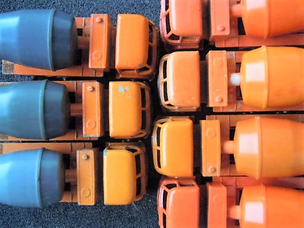

Idris wrote: Can anyone confirm a significant shade difference on this model?
Yes, there is a lot of shades. Not easy to take the picture with proper differences. There are even three shades of the orange painting by the very first models with the grey barrel
Re: 26b Foden Cement Mixer
On my VAIO screen, I can easily see Three shades.
The salmon pink (top right) is particularly striking.
