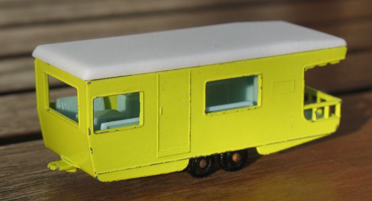

I will start with this trailer which I received with a broken roof.
Thats how it looked like when I got it.

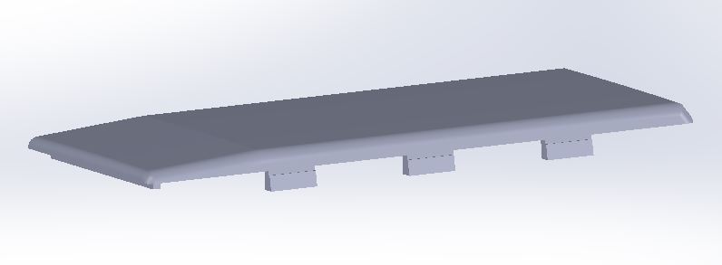

Because there is no replacement part avaiable I made a 3D-model on Solid-Works.
(c)-Malibu
(c)-Malibu
From this model I can make a so called stl-file which I can upload on the Shapeways homepage and place a order.
No comes the hardest part of it - I have to wait up to 15 days until I get the parts.
And thats the result.
(c)-Malibu
(c)-Malibu

Tinman wrote:I'm willing to bet the replacement top cost more than buying another loose model with a good top. It seems to be cost prohibitive at this time.
This part cost me 4,35 Euros. How much would a model with a good top cost? And of course you can buy another model with a good top but then you have one more model without top...
tjlglass wrote:I am reliably informed that when you try to bend this, it will snap as its built in layers and not plyable like normal plastic, also the texture is all wrong.
This depends on the material. There are materials which do reach quite flat surfaces. The strenghts of the material used for the top is nearly as high as the original. If you need a spare part like for example a boom it is possible to make it from metal as well.

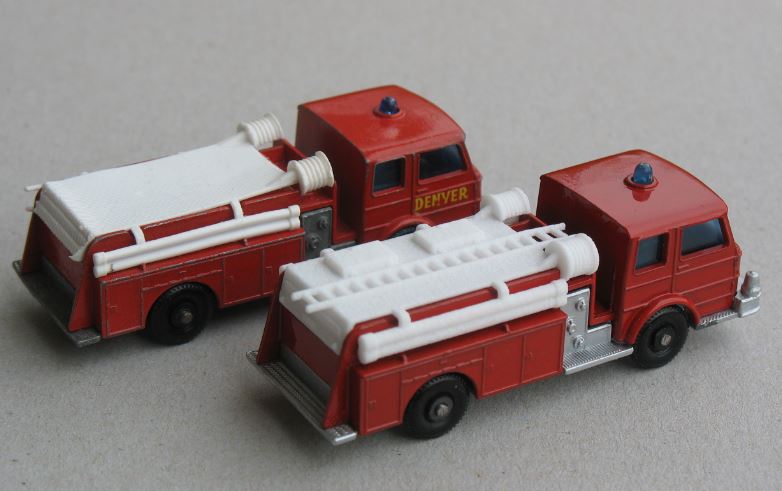

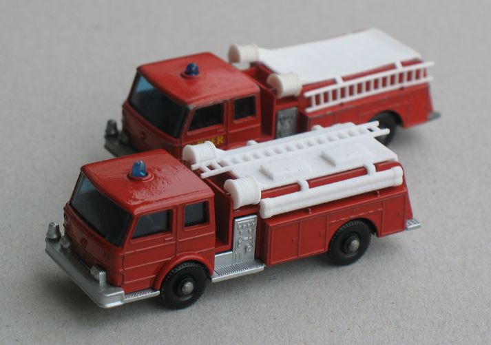

Today I want to show you a modified fire pumper truck 29c.
Thats how the model looked before.
(c) Malibu
(c) Malibu
And thats how it looks now.
(c) Malibu
(c) Malibu
(c) Malibu
(c) Malibu

Does the one without the extra ladder and stuff on top have the coiled hose details on the top?
