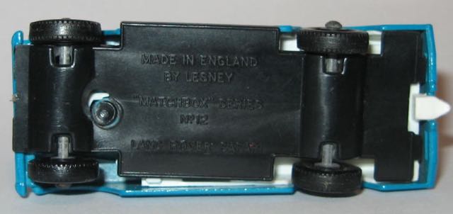

I have a similar misalignment on 12 Safari Land Rover.
The plastic baseplate is obviously askew. Perhaps operator had had a late night (or needed new glasses).
Slightly different than yours as you have a metal base in the correct place.
Wasn't tempted to reposition as the rivet is deep in the plastic (due to misalignment) plus it's a neat factory error.
Yes OK, it took me a minute to figure out Tinman's fix - bit slow.
