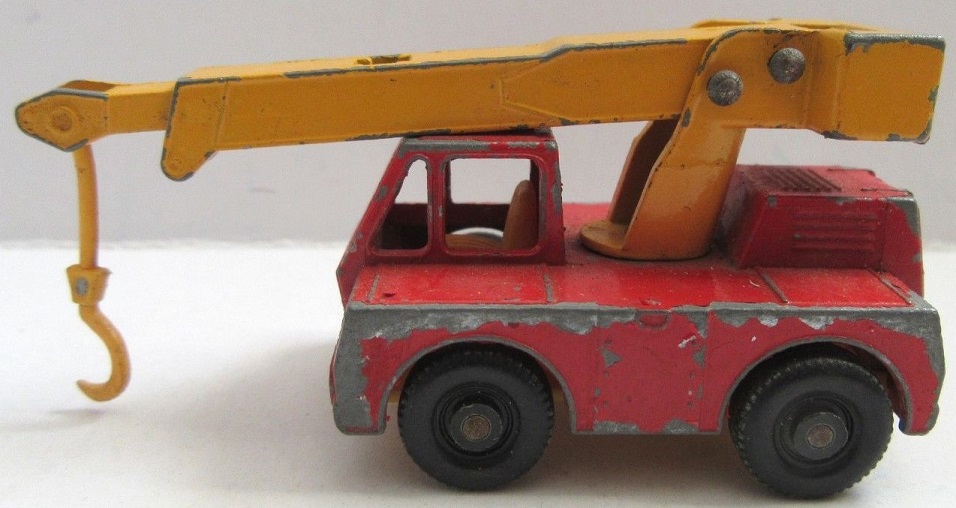

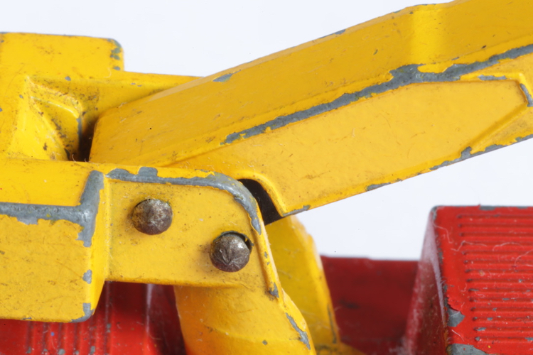

There are some unlisted casting differences on the crane arm. On the early cranes, the end of the arm has a profile with a right angle, so that the end of the arm itself is nearly vertical.
I think the earlier arm (with the profiled end and arched cut-out) would fit the later, lower pin position, so I expect there's a cross-over variation with the lower pin but the early arm. The two arm modifications may not have been simultaneous, so it's also worth looking out for the profiled end without the strengthened arch, or the other way round.
The peening is interesting - clear evidence of a rotating tool, I think.
On the later cranes this was filled in.
The cut-out on the early crane is a neat arch.
This was strengthened on the later cranes.
This is an interesting modification because the arch was needed to clear the high pin, but not needed at all on the later cranes. The strengthening piece rests on the pin and stops the arm drooping, but it would have been possible to delete the arch completely. I think the earlier arm (with the profiled end and arched cut-out) would fit the later, lower pin position, so I expect there's a cross-over variation with the lower pin but the early arm. The two arm modifications may not have been simultaneous, so it's also worth looking out for the profiled end without the strengthened arch, or the other way round.

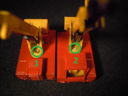

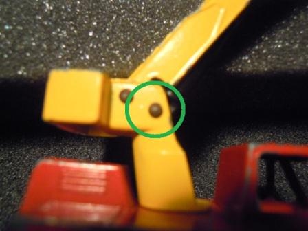

Very nice spotted Dr. Jeep. Very nice variation with the body lip. I have checked my models and I have not find the cross-over variation with the lower pin but the early arm in my spare models. Anyway I have found another interesting variations.
Most of my models have the large jib rivet, but there are models with small rivet also.
1) large jib rivet
2) small jib rivet
1) large jib rivet
2) small jib rivet

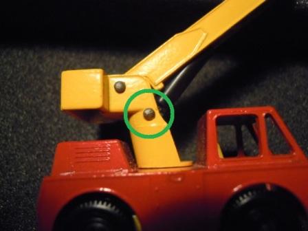

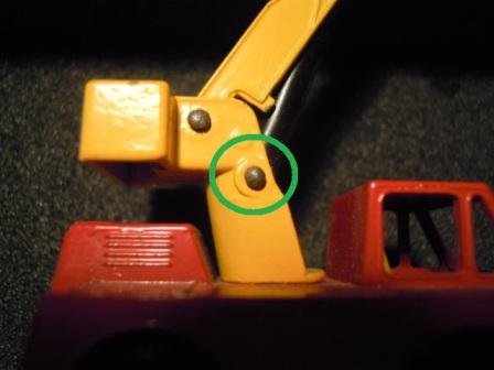

There are three variations of the jib holder:
a) upper pin, no strengthening ring
- DSCN6427.JPG (23.09 KiB) Viewed 3550 times

b) lower pin, no strengthening ring
- DSCN6425.JPG (19.93 KiB) Viewed 3550 times
Re: 42c Iron Fairy Crane
c) lower pin, with strengthening ring
- DSCN6426.JPG (19.28 KiB) Viewed 3550 times

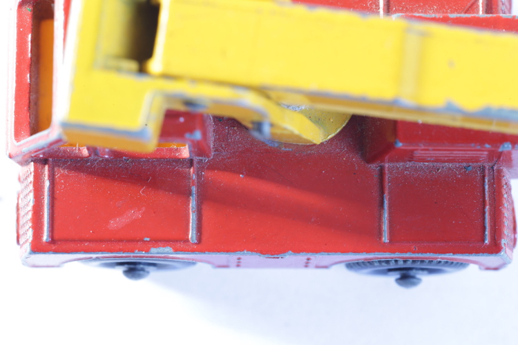

Thanks, Sebastian. I hadn't noticed the ridge on the upper body but it's obvious now you've told me. These pictures may help others. The later moulding is completely straight from above, but on the earlier moulding the area around the locker is wider.
This looks like another model that needs a new variation table!
That means there should be another cross-over, with the earlier body and the later arm. Diecast wrote:There are three variations of the jib holder
Thanks for checking, Antonin. I have the smaller rivet on the later model shown here, but I don't have the intermediate jib holder. Another one to find!Diecast wrote:Most of my models have the large jib rivet, but there are models with small rivet also

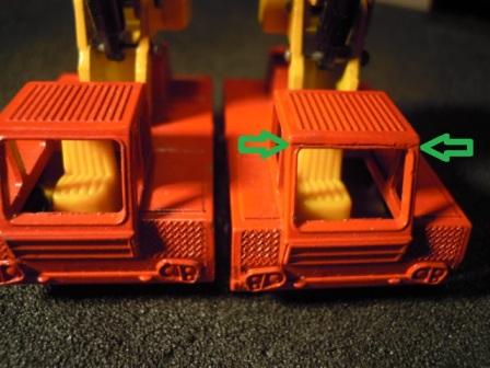

There are two interesting details on the body. First is the process of damaging molds. On the early models there is no rim or eaves on the roof.
