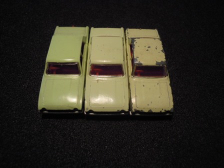

Here we are Hugh, I posted this photo of colours in my Casting Show.
The Greenish coloured model is the 1st issue with the Silver/Grey base plate, also the roof rack and the boat are a much lighter Green, it also is with-out any Silver trim on it.

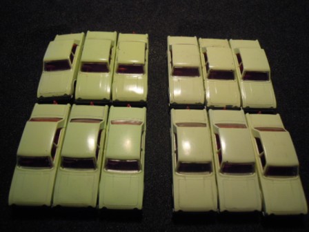

I have perhaps three shades (very hard to find the right description of the shades). The first and second one are very similar to the George´s models. But I have the pale greenish-white variation on the models with BPW and GPW also. In my opinion, the pale yellow-white variation is more rare.
a) pale greenish-white
b) pale yellow-white
c) pale yellow-cream

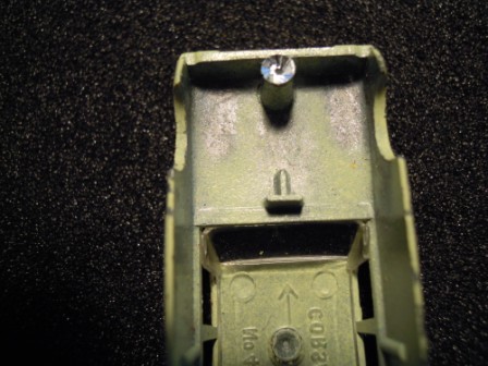

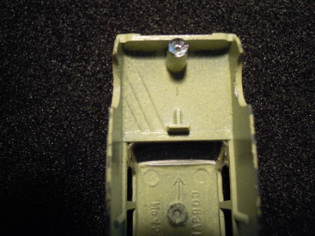

There is one unlisted variation (I have mentioned it three years before):
a) smooth bonnet interior
Diecast
Posts: 1571
Re: 45b Ford Corsair
Post by Diecast »
b) with three ribs on the bonnet interior

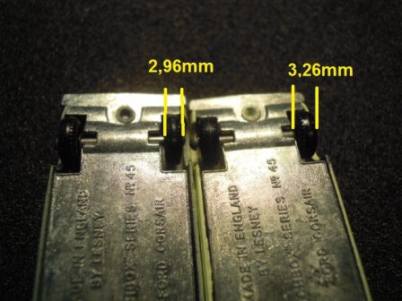

There are two types of the BPW ø9x36
a) 2,96 = 3,0mm
b) 3,26 = 3,3mm

Perhaps I had good luck and I was in the shop just when there was a delivery of the pale greenish models (on the left side). Anyway I have overlook yesterday that most of the greenish models have BPW ø9x36 and unpainted base plate, I have no greenish model with GPW . I must change my opinion, greenish models are more rare.
