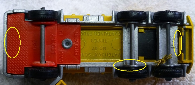

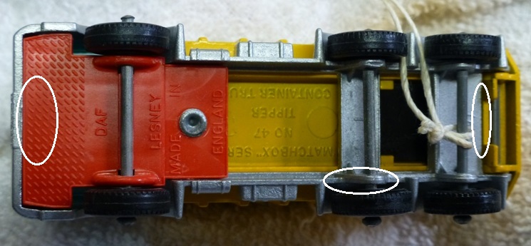

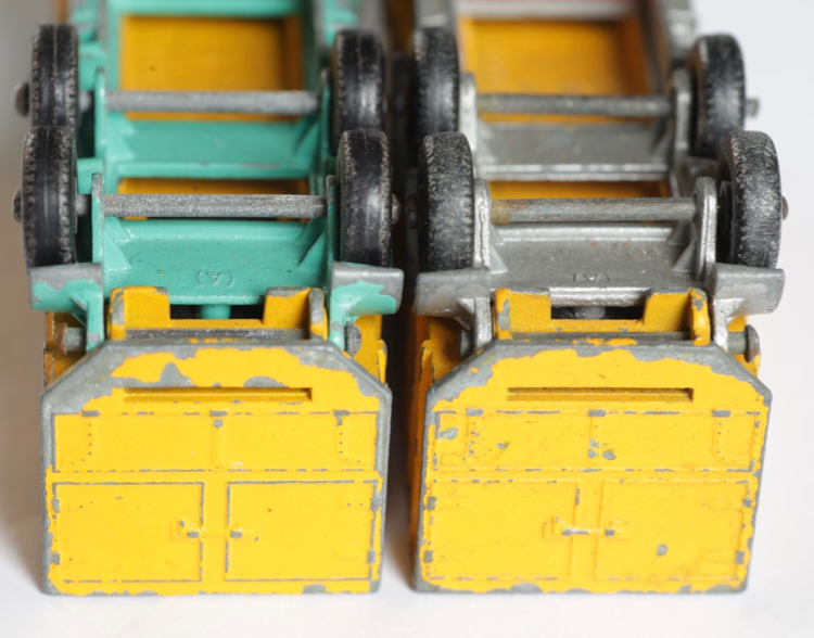

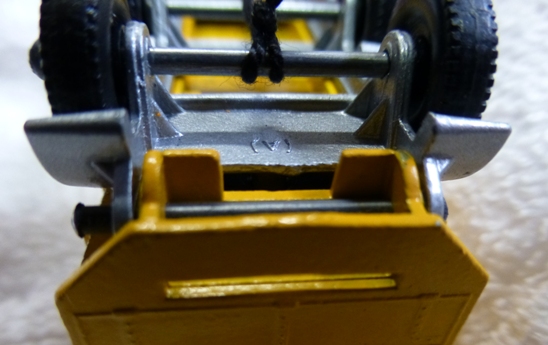

Bert got me looking for different tread patterns, and while I was checking the DAF container trucks I noticed another casting difference. The sea green truck on the left has narrow axle supports, which had been thickened by the time the silver truck on the right was made. This has the effect of making the silver truck's triangular braces look smaller.
The silver truck also has the well-known brace across the rear of the chassis (obscuring the (A) in this picture). It's possible that the axle supports were thickened at the same time as the brace was added - but I'd be surprised if we don't find an intermediate model. It's probably silver because there are silver DAFs with and without the rear brace.
There are also two different chassis and two different tipper castings. Both of these are chassis 1 (it's marked on the front cross member under the second axle). Chassis 2 may be different, so it would be good to keep track of this too.
- thin and thick axle supports

DrJeep wrote: It's possible that the axle supports were thickened at the same time as the brace was added - but I'd be surprised if we don't find an intermediate model. It's probably silver because there are silver DAFs with and without the rear brace..
Hi Glenn,

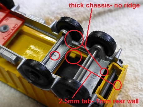

I have the 47c with thickened axle supports without cross-member brace on third axle with tow guide.
It has 2 cast on 2nd axle cross-member
This does not fit any M.Stannard code because Stannard does not have thick axle supports with NO cross-member ridge option as you are suggesting as the intermediate variation.
I do have it coded as NJ code 3 though as per current table determined by tow guide.

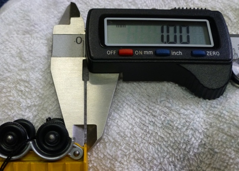

In the interest of keeping details accurate M. Stannard shows the type A container tabs as 2.5mm which is correct and not 2.00mm as catalogued.
On my examples of the 2.5mm tabs the rear container wall though is 1.0mm thick though M. Stannard says 0.75mm.
I would suggest if the M. Stannard type B container rear wall is thicker due to the addition of the ridge it would be more than the 1.00mm shown in the drawings.
I think any new table should have a column with chassis thickness (axle supports) shown.
And check this out, no post is complete without a new wheel type being found. We have here 44 tread wheels on this model on the axle on the base plate.
If you need any more pics please let us know.
Bert
- 47c thick chassis axle supports with NO ridge on 3rd axle cross-member
- bert 47c thick chassis axle supports NO ridge 3rd axle crossmember.JPG (116.88 KiB) Viewed 3763 times
- 47c rear of container wall thickness paired with 2.5mm tabs
- 47c rear container wall 1.0mm with 2.5mm tabs.JPG (98.2 KiB) Viewed 3763 times

Thanks, Bert - it’s great that you have this new variation, and good to know that the axle support change came first. There must be another intermediate version too: either green with thick axle supports, or silver with thin axle supports. There’s also the question of where the tow guide first appears. This will probably turn out to be complicated. The red base is shared with the 58c DAF girder truck, also introduced in 1968.
Both of my containers are around 1 mm thick, like yours. I don’t think I understand the different container bodies, so any pictures of the variants would be very welcome!

Hi Glenn,DrJeep wrote:Thanks, Bert - it’s great that you have this new variation, and good to know that the axle support change came first. There must be another intermediate version too: either green with thick axle supports, or silver with thin axle supports. There’s also the question of where the tow guide first appears. This will probably turn out to be complicated. The red base is shared with the 58c DAF girder truck, also introduced in 1968.
Not sure if I am understanding the "silver with thin axle supports" other than that there is one already listed, or is there something else?
I have not seen a turquoise with thick axle supports but I do have the silver with thin supports without cross-member ridge. This is without tow guide and is not a new variation but is Stannard code 2 NJ2 and Christian 2 and just for reference.
This has chassis 1 and container 2
I also have another unlisted silver with thick supports, without cross-member brace and this has NO tow guide. (the one I showed in first post has tow guide). This may answer your query as to when the tow guide appeared on this 47c. This chassis by the way is number 1 and container 1
Code would be new code 2a in Stannard, Nick and Christian’s listings.

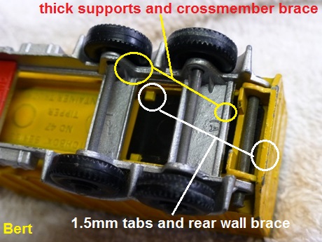

With reference to the container tabs and the correlation to rear wall variations here is 2.5mm tab paired with 1.0mm end wall photo attached.
The 2nd photo taken at an angle to show 1.5mm container tabs paired with end wall brace which measures 1.3mm. It also features mould number and thick axle supports.
Hopefully this detail will help those collectors who do not have access to M.J Stannard drawings.
Bert

- 1.5mm container tabs with 1.3mm brace or bumper
- 47c thick supports crossmember ridge 1.5mm tabs and 1.3mm wall brace.JPG (79.65 KiB) Viewed 3696 times
