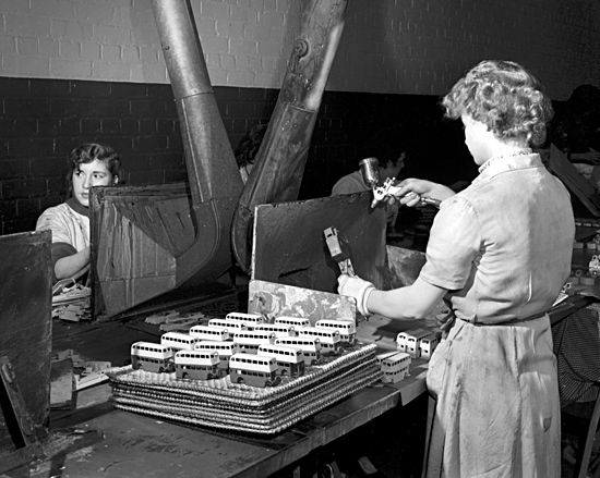

Looks completely correct from here. The Berlin connection stands up as a few of these have been sourced from there. Likely to be a special made up for the German importer for Meccano. Having said that this must be the easiest special Dinky ever made, a negative variation in fact, as all these were sprayed all over cream first then masked for the red / green overcoat. Luckily there is a photo of the assembly process at Binns Rd that shows just that.
Chris Warr.
