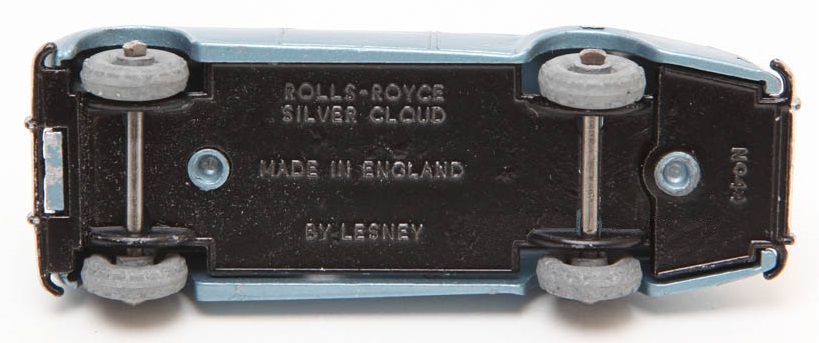

Three types of wheel design (with variations), were fitted to #44a.
1, The metal type, on crimped axles, usually called Bare metal, although in fact the factory had them Grenodised, giving them the dull Grey finish and fitted to the model from 1958 to 1959 when these were replaced by dark Grey plastic wheels.
2, The Grey plastic wheels were fitted from 1959 to 1963 and the first examples were still on crimped axles, then the safety axles with a dome at each end became the standard type. Three distinct shades of Grey wheels can be found, so we are looking at Dark, Medium and Light Grey.
3, The Silver-Grey plastic wheels stayed on the model from 1963 until 1964 when the model was replaced by the Phantom V. Two types of tread have been found on these wheels, the 20 and 24 patterns, refering to the number of ridges around the outside of the tyre to represent the tread pattern.

Here is an early example with metal wheels on crimped axles.
#44a base and metal wheels.jpg (107.91 KiB) Viewed 1285 times

by Fox
I'll have to examine closely the ones with crimped axles.
