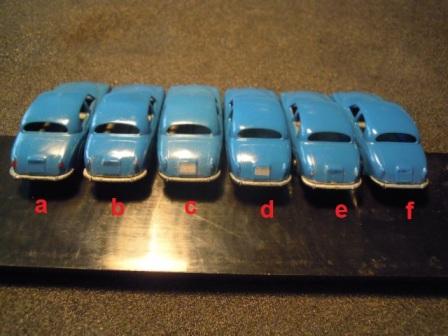

I have checked the rear silver trims once more. There is a lot of variations:
a) hand applied silver trim to bumper, hand applied red trim to tail lights
b) mask sprayed silver trim to bumper, hand applied red trim to tail lights
c) mask sprayed silver trim to bumper, large number plate & tail lights
d) mask sprayed silver trim to bumper, small number plate & tail lights
e) mask sprayed silver trim to bumper & tail lights
f) mask sprayed silver trim to bumper
- DSCN5218.JPG (25.9 KiB) Viewed 1430 times
