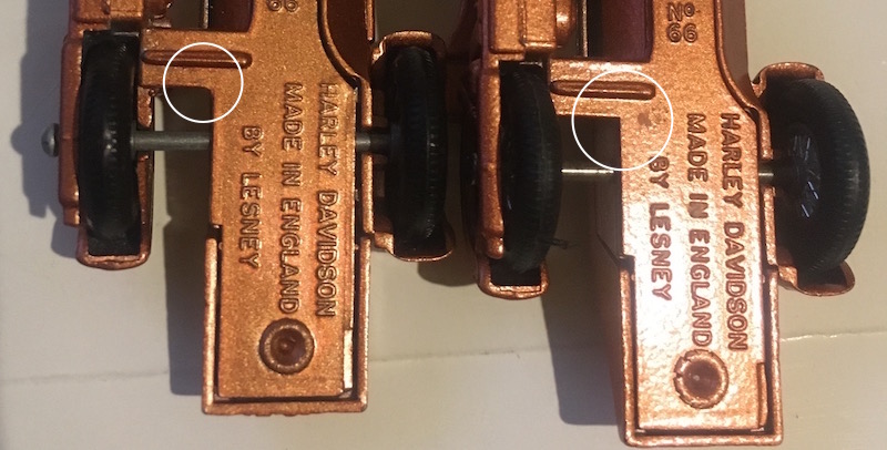

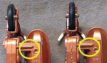

Re: 66b Harley Davidson & Sidecar
Just a note that the rear corner on the base can have a sharp corner or a small curve.
66b
66b
kerbside
Post by kerbside »
66b bases 480x421-003.JPG (40.09 KiB) Viewed 5851 times
This my photo that was on Nicks variation site, as you can see that one corner is a direct triangle not a curve.
This variation was placed on Nicks site back in 1914.
Hi George
I am looking at the rear brace.
Cheers J
