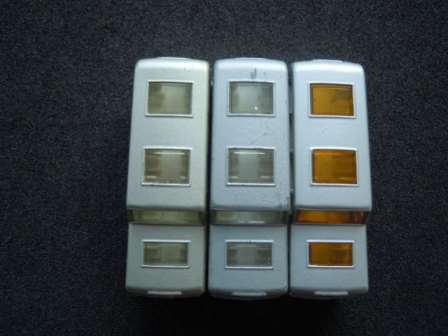

Re: 66c Greyhound Bus
I think it was not mentioned up till now, there are some colour/shade variations:
a) grey
b)silver grey
c) silver
a) grey
b)silver grey
c) silver

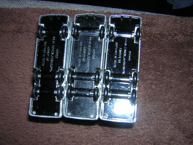

Re: 66c
From a recent spot the gem lot.code 14 matt black base,its the one in the middle,i did clean it and its definatly matt blackIdris wrote:The important thing here is that this would seem to corroborate Houghton, meaning we can safely conclude that there was at least one run of matt black bases for this model.
What we therefore now need to do now is to identify which of Nick's codes exist with both matt and gloss baseplates.
dave
- DSCN0358.JPG (168.37 KiB) Viewed 1454 times

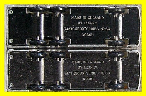

I have several bases, that are not shiny, but i´m not shure,if they can be called matte. What common RW would one recommend as a exymple for matte black to compare?
Roland
