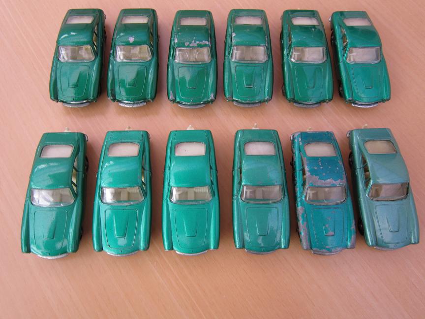

Could someone please post a side-by-side-by-side photograph of the three greens so that we can discuss them in an informed manner?
Re: 75b
This is an old photo that I took a few years back, not overly helpful but top left is dark green, bottom left is a mid green and lighter greens are next to that one. Of course there are shades of blue/green and the one bottom right is at the far end of the green spectrum.
Re: 75b
johnboy wrote:This is an old photo that I took a few years back, not overly helpful but top left is dark green, bottom left is a mid green and lighter greens are next to that one. Of course there are shades of blue/green and the one bottom right is at the far end of the green spectrum.
That all looks quite clear-cut and convincing. I suppose the big question is how consistent are these shades? (Judging by Kwakers' post above, my guess would be extremely consistent.)
What do others think? Should we go with the three different greens, or do we stick with Nick's two?

Johnboy has submitted a photo that shows what a nightmare of paint differences can be found on these Ferarris. I must point out that he doesn't seem to have one pictured with the last casting with the headlight eyebrows. That being said, even without my darkest eyebrow casting model pictured here, taking his top left and first two of the second row gives 3 distinct greens that we noted when they were brand new in their boxes at the stores. The used beater with it's blue-green color paint is of course the one I like best of all. :mrgreen: Thanks for Posting this old photo Johnboy, I remember it and my favorite model in it very well. kwakers

There are of course many shades, but there seems to me to be three very distinct greens in addition to the greenish-blue color.
Forgive me if I am being bold (or mistaken), but perhaps The Guide should reflect these findings.

I think you could be correct but after 40 odd years of varying amounts of exposure to UV light it is very hard to say.

I did attempt to update this page as it is clear there is three shades of green plus the bluish green, I was unable to update as I don't know what is missing. ie hub types etc
