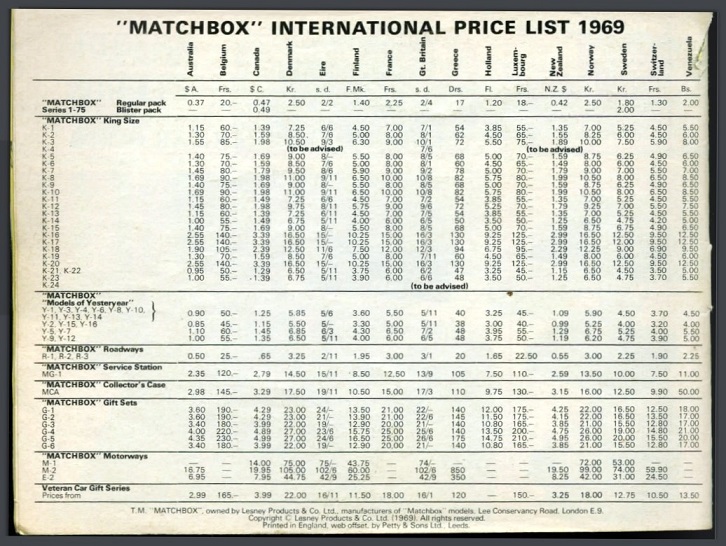

I have also shown the back page of this catalogue as it shows all the prices, but as you may notice, not the 'Superfast' models, nothing!
1969, 2nd Edition price list..jpg (185.29 KiB) Viewed 1965 times
