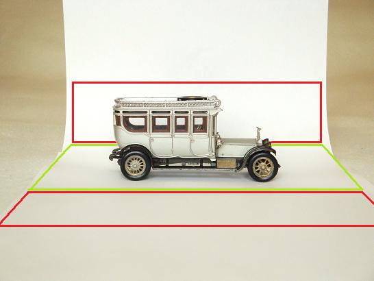

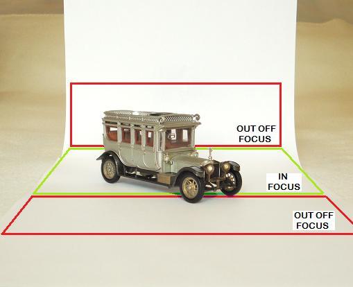

The first photo below shows what parts of the picture are in focus, this is quite a narrow Depth of Field and corners of the model will be out of focus. If you put the model parallel to the lens, the second photo, all of it will be in focus because it just fits in the Depth of Field area.

- IN and OUT OF FOCUS!.JPG (43.87 KiB) Viewed 912 times
- ALL IN FOCUS.JPG (44.29 KiB) Viewed 912 times

The model in the above two pictures has been nicely positioned and is the most used pose for model photography. If you use a modern Digital Camera or Smartphone, the lenses on those are classed as being quite 'Wide Angle' and the advantage of this will be a wide Depth of Field, allowing a lot of the area in front and behind the model to be in focus (as well as the model itself!), if you use Digital SLR type Cameras, the lens and metering system will adjust accordingly for the maximum amount of light to pass through the lens, but restrict the amount of the Depth of Field, causing areas in front and behind the model to be out of focus, so the lens will need 'Stopping Down' meaning the aperture will need to be reduced, limiting the amount of light to pass through. This will bring back some focus in front of and behind the model but the image will be much darker, so now we need to introduce some extra lighting.
If you can not change lenses on your Camera and virtually all Digital still Cameras and Smartphones have fixed lenses, then the simplest way to keep the whole model in focus is to place it parallel to the Camera as in the second picture.
