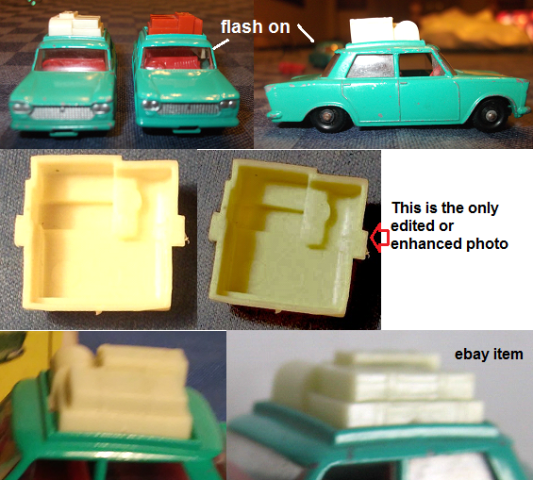

Re: fiat 1500 with white luggage
Malibu wrote:Hi all,
I do not think that this part was made by 3D-Printing but I can imagine that it is some sort of resin moulding.
I agree, it's a resin molding copy.
Ghosty's enhanced photo clearly shows that an original set of luggage was used to make a mold and then resin castings were made from that mold. That is why the ejector rings are lacking in detail (and other areas are not quite perfect).
A pre-production part would be made with the same mold that would generate production parts. It would produce identical parts in any color. If factory molds were used to make this part it would have sharp crisp ejector rings just line the brown example in a previous photo. This is someone homemade luggage (could even be Nik-Stil's or anyone's really). But it is for sure Not pre-production and not factory produced ... in other words: NOT genuine.
Here are some multi color resin castings of regular wheel Leyland truck front bases. You can't see them in the photos, but the ejector rings on these are much better than the Fiat luggage.
Here's a dark gray barrel for a 26b concrete truck, also a resin casting.

lesney0905 wrote:Here it is many others photos; I wish you would like them!
Hello Roberto and members,
Thank you for adding the extra photos Roberto,
The request for extra photos taken alongside something white (or a known standard light colour model that we all know) is to try and determine the actual colour and finish on your light colour luggage.
The new photos of luggage shows much better detail than the one shown in the ebay listing.
However:
It was the ebay photo which I believe had some readers thinking it is a replica made part because the ebay photo looks different to the new photos from you.
Unfortunately we now see five different colour results on the forum and a different colour again on the ebay listing of the same component.( see my photo bottom right corner)
With 5 different colours shown taken by possibly three different cameras, it is going to make this difficult to judge online.
You have the advantage in hand by being able to compare the light and brown luggage for finish, plastic properties and to measure wall thickness to determine if both components match and came from Lesney circa 1965. Remember it must be compared with a known GENUINE brown luggage as well.
Any other photos are best taken in natural light or good light source to cut out reflection and without flash.
Another good tip is to have both pieces facing the same way, we need to see like for like details.
Here are all the images together. None of the images have had properties altered by me but have been cropped to fit apart from the enhanced photo from ghostmaster (Kevin) which I have marked.
As you can see, the same plastic component can offer many variables courtesy of different digital cameras and different lighting conditions.
I also took one of my light tan luggage which has good provenance. It has the letter M inside and the lower ejector ring is flush with main surface and the ejector ring on the block is 0.23mm high.
I hope this helps and is only seen as being positive in trying to work out if this luggage is real, not just for you but for all collectors hunting for genuine Lesney history.
