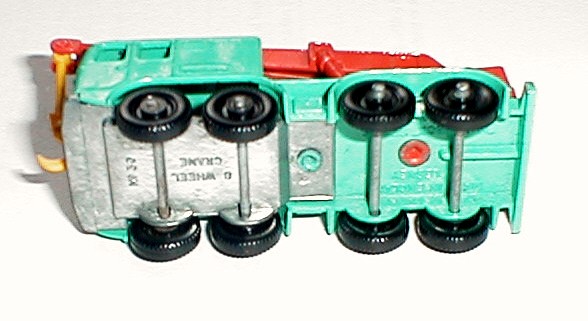

Don, can we see the underside of your Mint Green crane please.

Hi Ghosthunter. I will send it through Kevin .Don
Re: 1966 Commercial gift set
Posted: Thu Sep 01, 2016 10:31 am
Thank's Don, here is your Mint Green crane underside and I was hoping to see a plain rear section minus the long brace, sadly yours has the brace, so don't make plans for retirement just yet... :D
Posted: Thu Sep 01, 2016 10:56 am
GHOSTHUNTER wrote:Thank's Don, here is your Mint Green crane underside and I was hoping to see a plain rear section minus the long brace, sadly yours has the brace, so don't make plans for retirement just yet... :D
I think you're missing the point here, Kevin. This is not simply a mint, green 30c crane. This is a mint 30c crane in mint green (which means we're in hen's teeth territory).
Posted: Thu Sep 01, 2016 11:19 am
Yes I know that, but imagine it without the brace...
Posted: Thu Sep 01, 2016 4:21 pm
by Miller
GHOSTHUNTER wrote:Yes I know that, but imagine it without the brace...
Well then the rear would sack away and break - in this case it still would be mint, but no longer mint! :D
Posted: Thu Sep 01, 2016 11:32 pm
by Toyman316
Ghost hunter did you buy yours individually or in a set. I have checked my resource books and the original model had green paint and chassis.
A body and A base . released in Aug 1965. This model was produced later with A body and B chassis, painted mint green body or turquoise and released in the G-6 gift set in 1966-67.
My set was complete and purchased from Woodwards store in New Westminster, B.C. Canada. According to Mick Stannards book it was s done for the gift set. It was not one of the first models produced in1965 and is listed as produced with A base and B chasis.
Posted: Fri Sep 02, 2016 12:08 am
Hello Don.
I don't actually have examples of this crane, but I like to see hard to find models when members bring them to the forum and its always wise to see all sides of a model in case there is a surprise for us. Knowing this casting was at one time minus the rear brace, its wise to check every casting that comes our way on the forum because it is becoming increasingly well known stocks of castings at Lesney are often not used in the order of their production !
