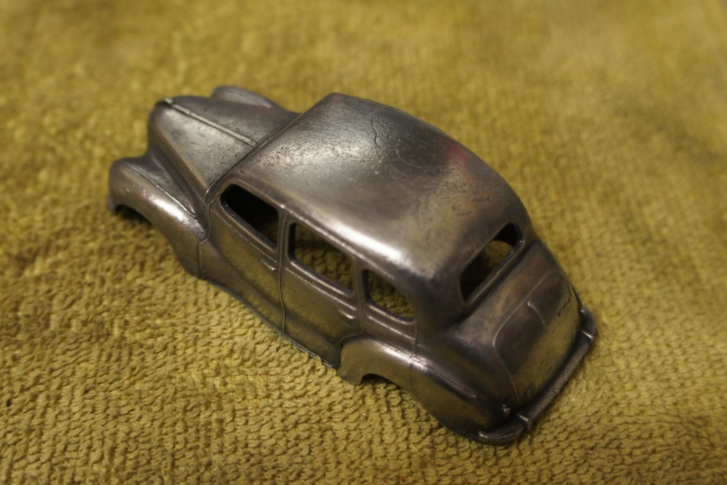

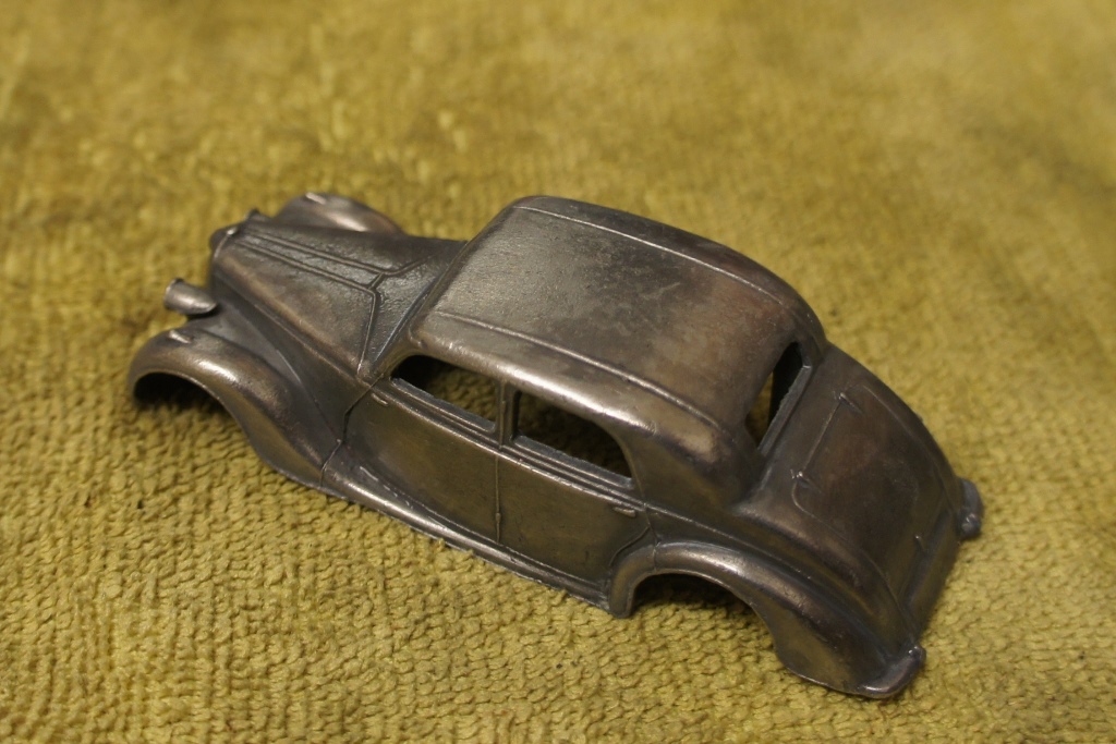

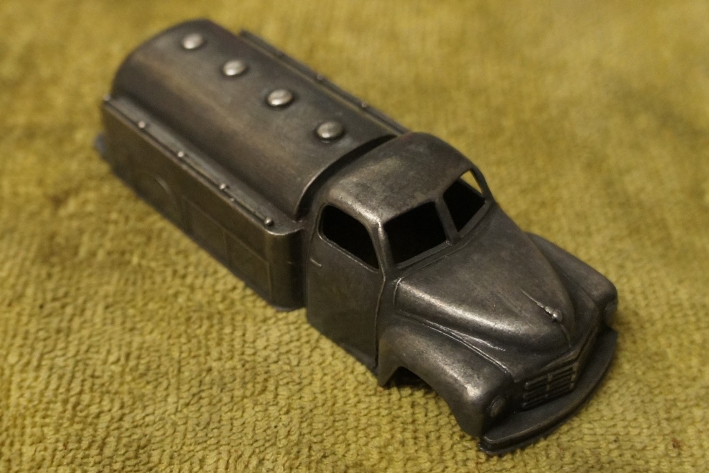

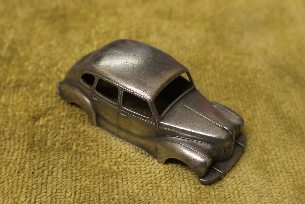

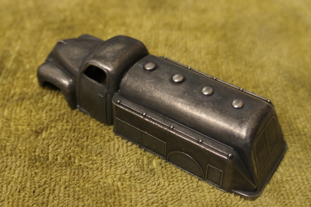

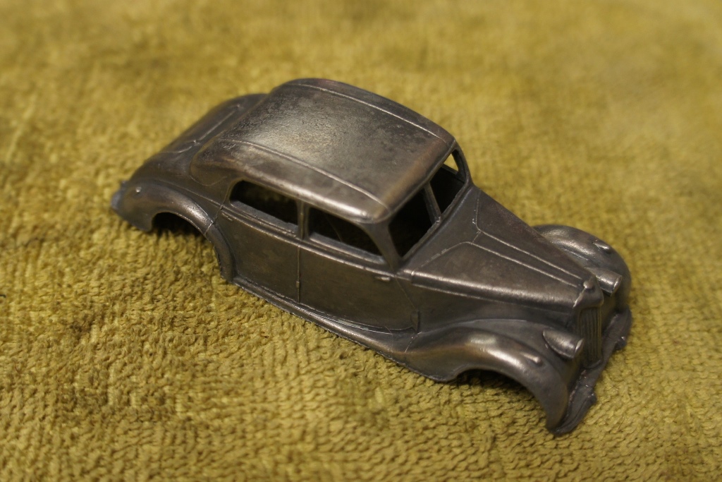

Those 3 stripped Dinkys are just superb castings..I was reading somewhere that Dinkys originaly had raised shut lines like Spot on .That had never struck me before but in those you can see it for real...Little pieces of art indeed...

Aren't they just?
The first Dinky GB model with recessed shut lines I can spot is the Triumph Herald in the 1959 catalogue.
Dinky France was years ahead, their first model with recessed shut lines is the Buick Roadmaster, released in 1954.
Apparently to make recessed shut lines requires spark erosion technology in the mould making process.

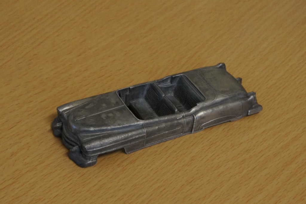

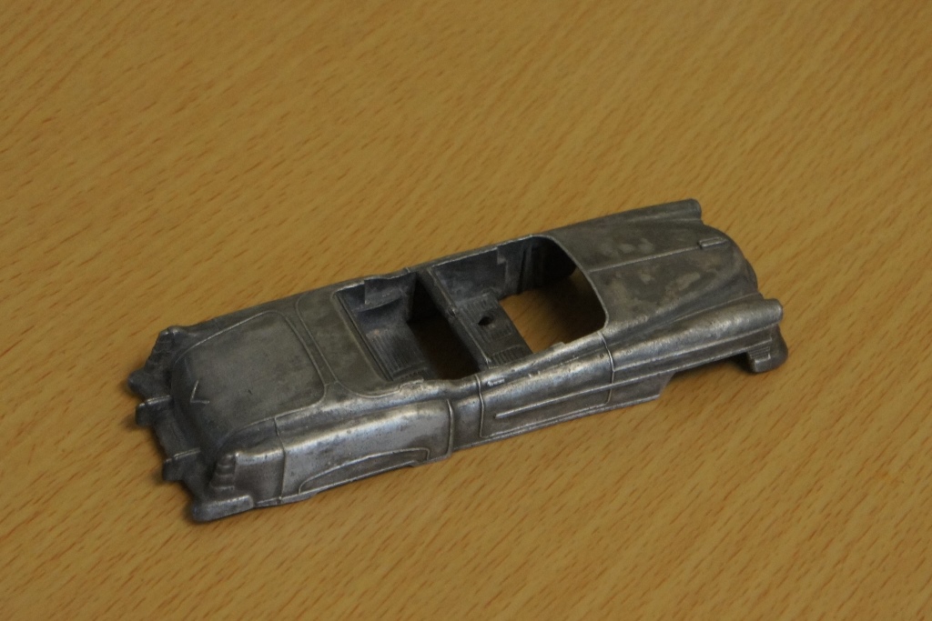

Anyway, more raised shut lines have been exposed.
