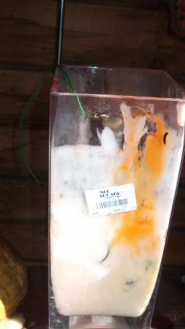

OK my much preferred method of removing paint is now set in stone.

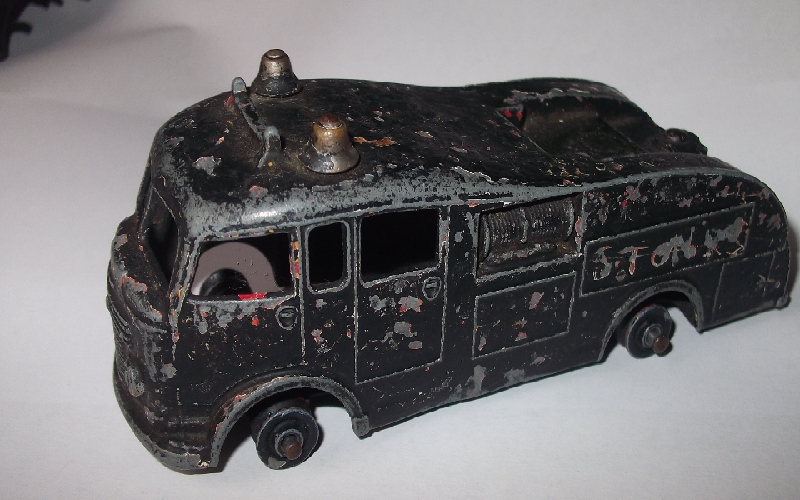

For a few years before retiring I was working as a lacky at B&Q and in that period Nitromores changed there chemical recipe to a more user friendly base. Now for anyone trying to remove 60 year old baked on finishes from Dinky ,Corgi,Lesney to me there stuff just wasnt cutting it.Maybe I was expecting to much to quickly but a fast strip was no longer possible[IMHO] So a slower and CHEAPER product has now become my staple chemical..
..I hate to say this but B&Qs own that comes in a white plastic container given the time and a deep enough jug will shift most paints,its relatively cheap and doesnt smell to bad.Also no wheels where eaten . :D
I like to then give mine a quick wash in thinners {check Lldl for Baufix] thougher rinse in a bucket outside to get rid of the smell and then let it join the washing up indoors....Then the bit I like picking with a scalpel and a brass wire brush from Poundland.[Other cheap shops are available]...
Plastic goes in the tank today if I can find something with a bit of old paint on but I do know from past working that a certain oven cleaner works safely as I did a Pocher kit a few years ago and its still in one piece [Well a lot realy but thats another story ]

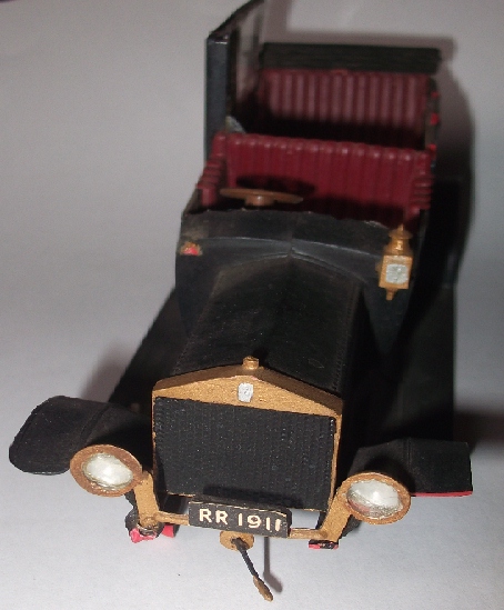

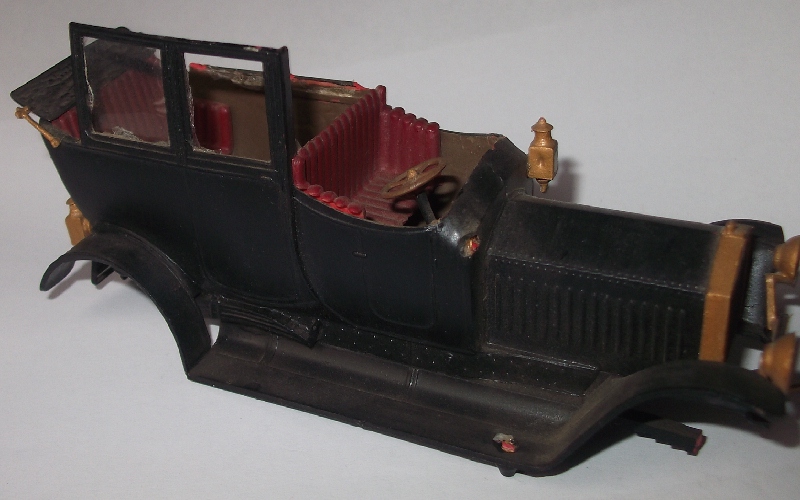

I take it the old Airfix Rolls-Royce is destined for a dunking to reveal the original plastic (bright Red in this case), underneath that high quality paint job by a previous owner!
This I must see...
misterpop
Posts: 1311
Re: Cleaning/removing paint off of model...
Post by misterpop »

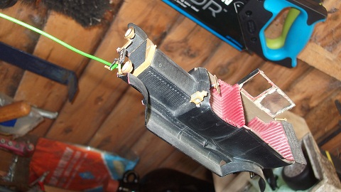

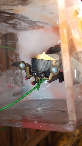

Now steady down Kevin..Not in a month of Aprils would I consign this fabulous hand crafted collectors item to a fate worse than death..No indeed the front half was purchased as a front end for a code 3 Rolls Royce I was thinking of constructing on the front of a General Bus...Rest assured that only the back end will be submerged in the deadly chemicals...As you will see tomorrow when I can get back to the shed......Updates on its progress will be broadcast when and however things do or dont materialise.....Night all.
