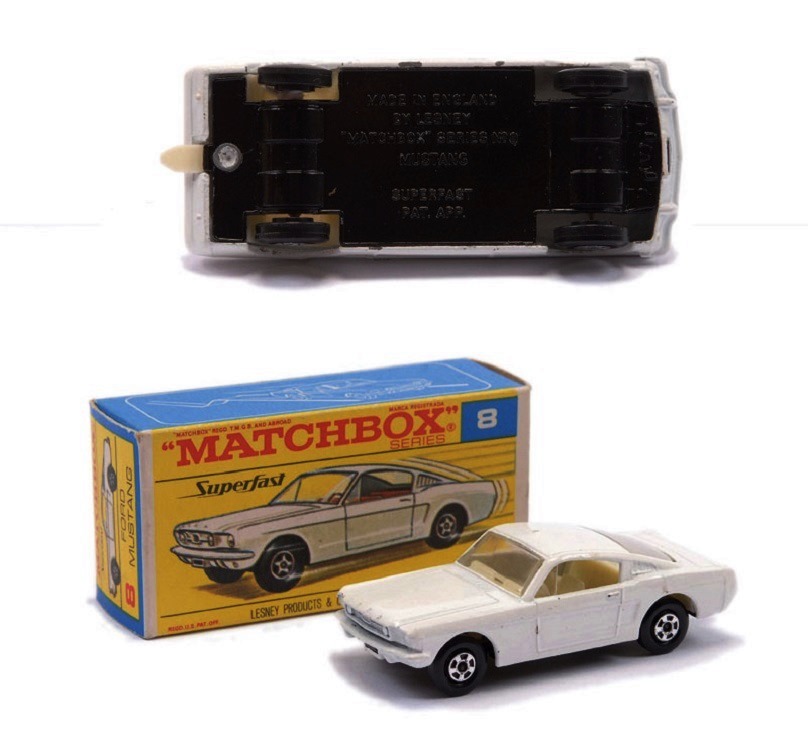

Heres a pic of a similar White Mustang which i had saved.Not sure about when or where i captured it.
Also seems to have front-end damage/distortion & paint flaws on roof as well.Maybe the experts can compare the paint.

Re: SF #8 Mustang Rare???
The above picture posted by "Numi" looks like a 'VECTIS' picture, if that helps!

numi wrote:Heres a pic of a similar White Mustang which i had saved.Not sure about when or where i captured it.
Click to have full view.
This rivit is properly spun looking like a typical RW 8 for rivit appearance and white paint finish.No signs of any sort that baseplate has ever been off this 2nd car. This 2nd car also has thin 10.5mm diameter wheels as fitted to other believed genuine SF8 trial/sales sample models rather than the specially made for this mass produced model wide 10 x 4mm wheels seen on Bob´s example.Paint appears factory with no touch ups unlike the 1st car which is the chalk to numi´s cheese! Although I can see what looks like casting damage under the paint by the R of FORD on the hood.
The only bug in the ointment is the wheel size - these few believed genuine thin wheeled SF8 pre-pros/colour trials are the sole proven mid 1969 models fitted with 10.5mm diameter wheels rather than the 11.2mm wheels fitted to all other 1969 releases although the SF25 Cortina GT was reported as available in a few US stores at the last moment before christmas 1969 - all other early SF releases apart from the Mustang which pioneered the common 10mm wide wheels and the SF45 which pioneered the larger 11.5mm wide wheels had the same 11.2x2mm solid wheels

You asked for a similar model with very similar casting damage Mick, and I will bet Vectis did not rate this one as a condition 7 model as Bob did the one in his listing. Similar damage? Almost exact in my opinion.
By the way Numi, you are one of our 'Experts', so you can talk to yourself now about oddities. The problem arises when you start answering yourself like kwakers does.
The fact that you saved this Mustang's picture with it's white interior says it all Numi, Thanks for digging it out for others to see........

Chisel split rivits on the roof of SF8 Mustangs to hold the glazing in seem to be common looking at my examples as does damage visible on the outer roof from the operation, but no casting damage around the R (at the opposite point on the body to the base rivit) on any of mine.
