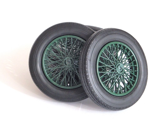

Yes, I had a loose valve so a tyre kept going flat...!
The wheels are made 'OOB' but had to have the inner rim surface painted to try and minimise the reaction of the Nylon based tyres touching the Styrene plastic of the rim, as due to the age of this particular example (1975 she was brand new!), the tyres had started to shed some chemicals and would have caused a problem with the rims had I not tried to do something. The tyres themselves were cleaned with house-hold spray polish. The little valve is just a tiny piece of fuse wire with piece of wire insulation popped onto the end to represent the valve cap, then just painted Silver.

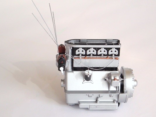

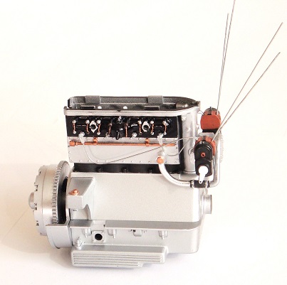

Plug leads being fitted.
Fuse wire again stuck in some pre-drilled holes on each magneto, ready to be fed across to each spark plug and connected with just a tiny nylon sleeve. The leads on these cars are not fixed like modern cars, they are at an angle and held in place with the supplied screw terminal for each plug. Two each side are now done, Two more each side to do.
The other side. You can see I have also added some plasticard to the switch-gear of the magneto, the White plastic on the lower part, this will have a lever or Two and some connecting rods added.

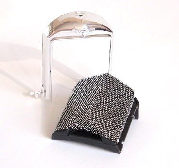

While parts on the engine and wheels were drying I tackled the grille and while it looks OK straight out of the box, this is one component I decided would be superdetailed. The real car has 'Stone Gaurds' in front of the headlamps and a large Gaurd covering the radiator. I wanted to replace these with some real mesh, so brought some tea strainers for a £1 as they had a mesh pattern close enough for the kit. The mesh once fitted would foul the plated grille surround, so severl layers of plastic were shaved away from it's inside surface. The mesh was simply cut to an overlarge shape and simply offered to the surface of the plastic mesh component and the edges folded around the back, that's it, it is not even glued and if you touch the mesh with your finger it can be moved slightly.
Part #166B, represents the wire mesh Stone Gaurd and all I did was place my new mesh onto this and fold the edges around the back. This did however mean the whole assembly is now too big to fit the plated grille surround #168C, so some trimming was done to the locating pins on the back of #166B and the locating posts on the front of part #167B.
Here is the finished mesh component waiting to be fixed into the plated grille surround.
Another very important job to do on the grille is to remove the 'Fying B' Bentley badge and move it further up from where it is. Amazingly Airfix moulded this badge too far forward, so it faces forward but on the real car it looks more up into the sky!

Here the engine has all the plug leads now in place and painted.
I have also finished the starter assembly and decided to leave it engaged with the starter ring. This part is not supplied in the kit so found an old friction powered toy car, cut the axle with the small cog at the end, drilled the plastic part protruding from the side of the block, made a small spring out of wire and push fit the unit into the pre-drilled hole. The actuator unit on the other side is supplied in the kit, but I have added some extra detail in the form of the little stepped strip on the side and Four bolts on the end-plate, will add a small connecting cable later.
The other side of the engine now has the Two 'Blow-Off' valves attached to the inlet manifold, they are the round objects.
