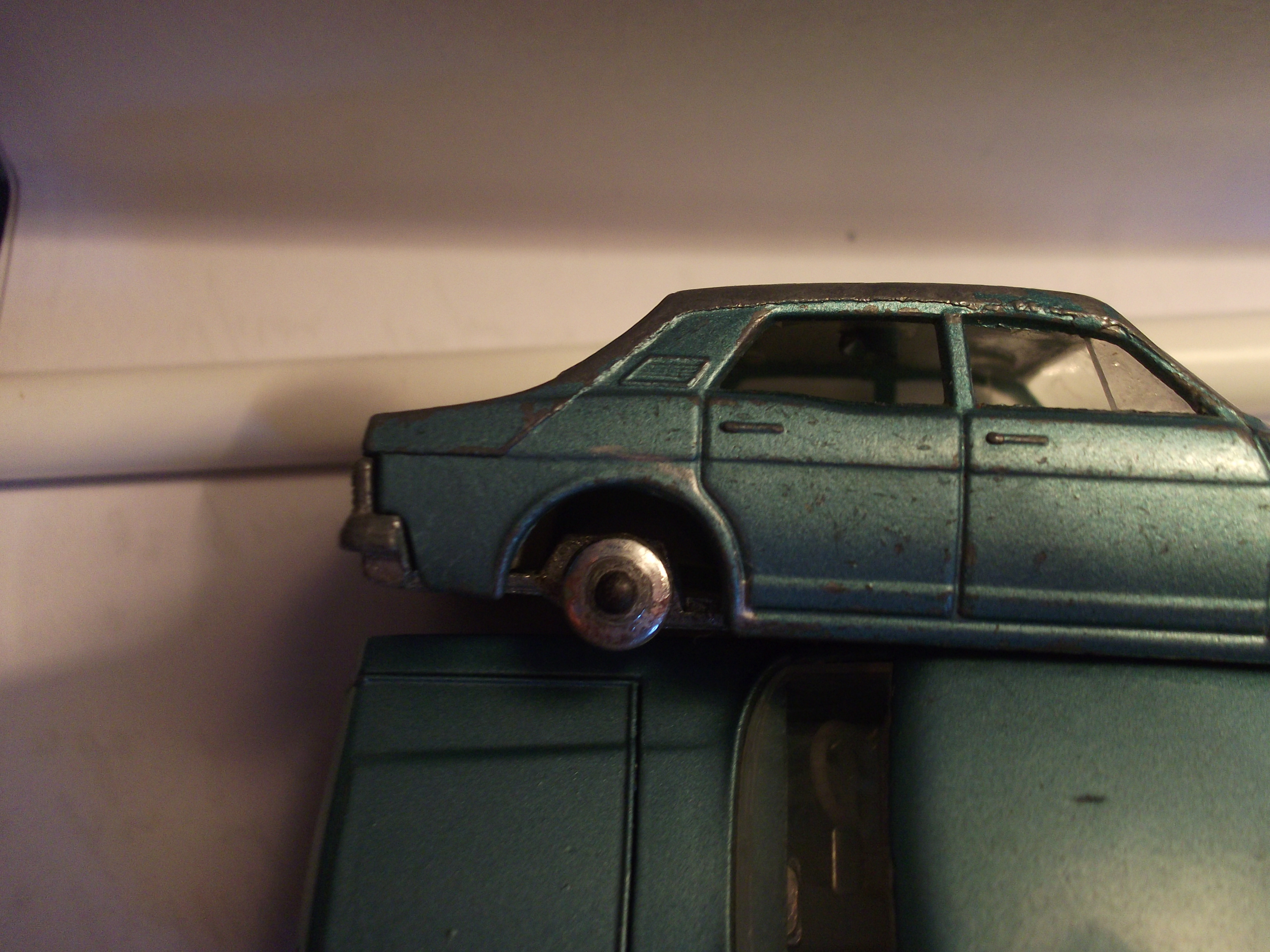

Although"cut' n' shut" axles appeal because this leave not only the peened ends but also the baseplate rivet intact, as Mick highlights, it does create its own issue in terms of aligning both ends of the axle correctly. I can therefore see mileage in cutting the axle hoops, dropping the replacement axles in, and then closing the hoops again by some means, although this then leaves the problem of a convincing baseplate rivet. I suppose it's swings and roundabouts from a fakers' point of view. Which can he do best and which is most likely to get past a collector's initial scrutiny?
Even if we can't determine how the wheels have been done, one thing's for sure: with that body casting, this is a fake.

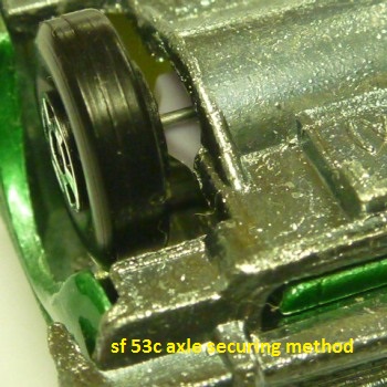

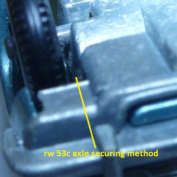

Whilst the axles do have suspension on the regular wheel model the axles are held in place by the base plate casting arch opening (see my attached photos), unlike the superfast model where it is held by the plastic suspension.
So to add the chrome hubs with tyres and axles (wheel sets) as complete units does not apply to the RW 53c as axles need to be fed through the base plate arch opening then under the suspension through the base plate arch opening on other side and then have second wheel fitted and then small axle end finished.
So therefore the rivet and base plate concern does not apply in the case of doing wheel swap on the regular wheel model.

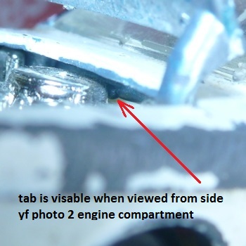

The engine compartment looks to be without the central tab. If so, then (according to Nick's catalogue page) the body is a later casting which means that the model cannot be a pre-production.

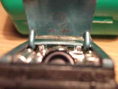

However the angle at which the two photographs were taken and provided by lesney0905 of the engine view are too steep to show the cross member (brace) that has the small tab between the two blocks.
The carby air cleaner is obscuring the view of tab position. On the models I checked I can only see the tab when viewed more to the side. If you look at the photo on Nicks variation page the carby is sitting lower on his and you can see the cross brace and tab. Not all engines sit that low on every model.
Lesney0905 needs to show us this view to the side or definitely confirm it has tab OR no tab.
Given that the rivet does not need to be touched to fit new wheels it means we are back to comparing hubs and axle ends to determine if this is genuine. The current photos are not in focus or of a high enough quality to make judgement on the axle ends.
Roberto, could you please tell us if your model has the central tab or not and add some close up clear photos of small axle ends. Thanks.

Hello Bert, I managed to remove the tires from the model, and I saw all the details that you have stated in your post: there is the suspension bar of green plastic, the cover axis of the frame are perfectly intact, and behind the air filter is the bar you are talking about, therefore the only way to forge the model is through the end of the wheel axles. reviewed carefully by a good magnifying glass, I can say 100% that they are intact! conclusion I can say with my joy that the model is not a falso.thanks Roberto.I attach the photos, unfortunately I do not have a camera with high resolution.
