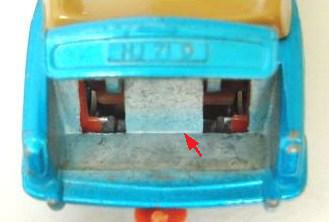

The door locks will be large or small, the body panel below the front number pate will be smooth or have two vertical casting lines, the front air-vents, (under the headlamps), will be large or small and a very easy I.D. detail in the boot, is the join from the bottom of the backwall to the floor, it will be sharp or smooth.
These details are for the first and second body castings, possibly the third, but certainly not the fourth, (the opened up wheel arches for the wider wheels) and with clear pictures of all or some of those details, will help in putting the 'flat black' base version in the right place in 'MY' listing and of course Nick's 'Code' listing.

GHOSTHUNTER wrote: The door locks will be large or small, the body panel below the front number pate will be smooth or have two vertical casting lines, the front air-vents, (under the headlamps), will be large or small and a very easy I.D. detail in the boot, is the join from the bottom of the backwall to the floor, it will be sharp or smooth.
I have just had a close look at all of my 22 different 69c examples (eight in metallic blue, twelve in gold and two in lime gold), but I am totally unable to spot any of those differences.
The body panels below the front number plate are smooth on all of them (where would I have to look for two vertical casting lines?), door handles (is this what you call door locks?) and air vents below the headlamps are the same size on all of them, and I cannot see any casting differences inside the trunks (boots) either. (I have to say I do not know where a "backwall" is to be found, as there is no wall at the back of the trunk, only at the front.)
Comparison pictures of those differences would probably help, but for the time being I am clueless...

OK Chfalkensteiner,
BACKWALL to FLOOR JOIN.JPG (17.57 KiB) Viewed 2878 times
The arrow is marking the Backwall to Floor join, this is 'sharp' and I have three models with this profile here. All models made after this have this area much smoother, not just tool wear smooth, it has been deliberately rounded off in the tools/moulds.
I will take some better pictures of my noted details from my earlier post, but am a little surprised to hear you say you have not seen any of my detail variations, especially the door locks, the actual door handle is about the same size between body casting 1, and body casting 2, but the circular blob representing the lock under the handle, is definately smaller on body casting 2, plus, underneath the rear bumper, the area in the centre which has been cut away for the tow hook arm has rounded sides as apposed to the sharply cast sides on body casting 1, all will become clear when you see the pictures.
