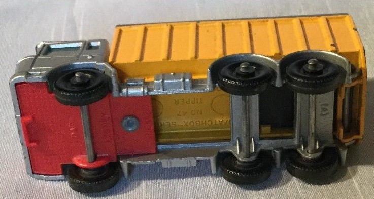

I think this example is one that may be a little harder to find
Details are
1 Tipper body with number 1 cast, 2mm tabs, no rear bumper and faint casting ring on black hydrosleeve
2 Silver chassis with original thin rear axle mounts, number 2 cast and no rear cross member ridge
3 Dull/darker red plastic baseplate with 7mm wide tow guide
4 Silver lid on tipper body
Happy collecting
Sebastian
Details are
Happy collecting
Sebastian
- a copy of DAF silver container truck with tow guide base view.jpg (114.79 KiB) Viewed 2203 times

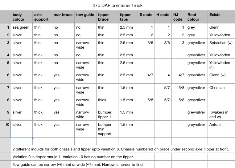

With thanks to all who've contributed, here's my latest attempt at a variation list for the 47c. I've decided (perhaps wrongly - you tell me!) not to distinguish between the two different tow guide widths. The logic for this is that they both seem to be in use throughout production, though I think the narrow tow guide is more scarce. Similarly, I've just noted that there are two bases and two tippers because they seem to be identical. The exception is right at the end of production when an unnumbered tipper appears. This is either a heavily modified tipper 2, or a new moulding completely. Careful examination of text and ejector rings may shed light on this, if anyone feels like investigating.
Anyway, as usual, tell me what's wrong and what's missing. This one has been fun. Bert's shown us a completely unlisted variation, Sebastian has shown an early use of the tow guide, Kwakers proved that the two different tow guide widths survive to the end of production, and we've started to unravel the mystery of Antonin's late model that tips much further.
- DAF 47c March 2018.jpg (124.13 KiB) Viewed 2151 times

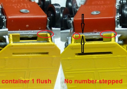

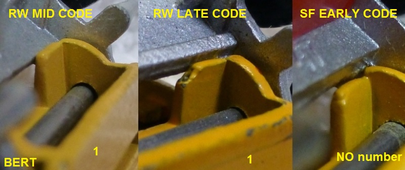

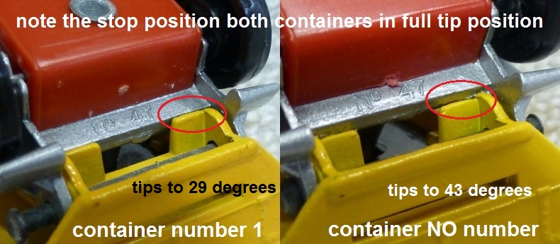

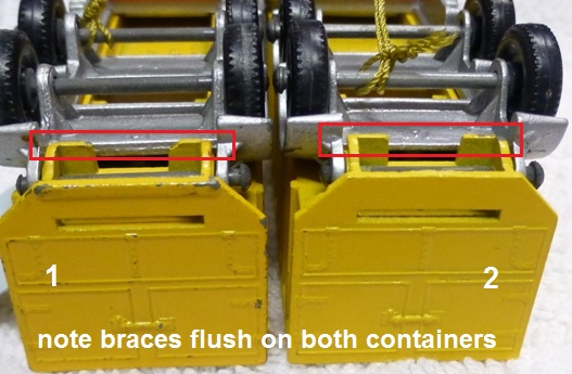

The mechanics in determining how far the container will tip are governed by:
1. The rear chassis cross member thickness (ie poorly cast top edge)
2. The container brace that adjoins the container pivot axle supports ( acts as a stop )
3. The size of axle holes and diameter of axle/pin. (extra sideways movement)
Please note to explain my thoughts I have used a SF example of NO number container. I do not have a RW NO number container and I have yet to see close up photos to show this info.
The key is the container brace which I have circled or blocked in red.
On the RW container 1 and 2 this brace is almost flush See photo 1
Towards the end container 2 starts to develop a step..see below.
On the SF, container 1 is, but on NO number they are not. See photo 2
The NO number container now has a step and this allows the container to tip at a greater angle.
In an earlier post I wrote that 4 sf containers tipped to 45 degree. However after putting a special 47c digital angle gauge on them the results were different.
My container 1 tips to 29degree but my NO number tips to 43 degree
If this step happened when it was a RW on the NO number container ( when it lost the number 2) then the angle of tip changes.
Therefore the container brace with step on the RW may not act as a stop and this will allow a 90 degree tilt especially if the axle hole is slightly bigger allowing a little side play.
If you look at photo 4 it is only a small amount of rough casting on the cross member that is stopping this from tipping to 90 degree. ( please note this is sf model and not exactly the same as Antonin’s.)
It would now be interesting for Antonin to confirm that his regular wheel model has container with NO number type that tips to 90degree and which points of the 3 above are relevant.
Bert
