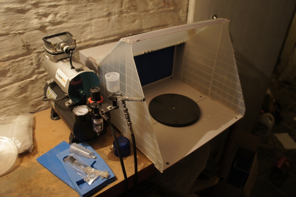

It's worse to have a too powerful compressor than a too wee one.
This is the one I am using:
70 quid and so far it has provided sterling service.
I use those 1 Pound artsy fartsy acrylics thinned with screenwash (bought for 1 Pound for five litres) on top of etch primer followed by white car primer.
Then I shoot 3 layers of Aldi rattlecan 1K clearcoat on top of that and whooshbonk.
So here goes again:
1. Etch Primer
2. Car Primer
3. Acrylic paint airbrushed on
4. 3 layers of Aldi 1K clear from the rattling rattlecan, heated to ca 50C and shaken, not stirred
If two tone, a thin layer of clear must go on top of the first paint before masking.
Then the Silver is done with a sharpie, which costs - you guessed it - a Pound.
Other details, like taillights, indicators and such stuff are painted by hand with Humbrol Enamels. I have yet to find a substitute that looks as authentic.
Hey, I'm fully aware of how daft this sounds, but look at my models. And they merely cost me Pennies to restore if I just ignore the fact that Steve Flowers can live the high life from what I pay him.
