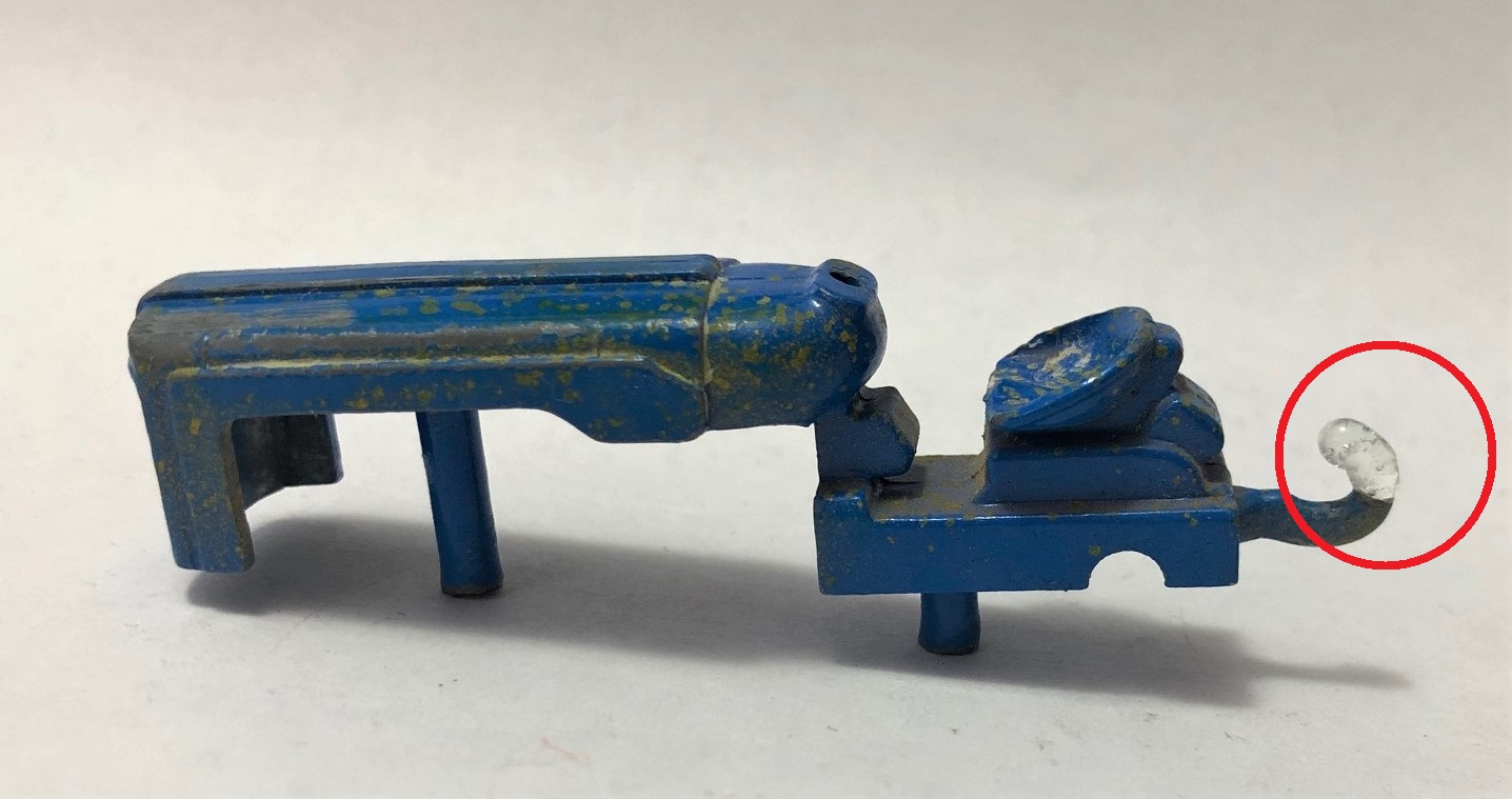

In photo's below you will see a Kingsize Matchbox tractor with half of the tow hitch broken off. There are some good ways to fix this problem: Muggy Weld, UV light cure bonding/welding glue and epoxy.  My first impression was to tackle this with JB Weld "steel" epoxy.  It failed on two repeated attempts. The epoxy just could not obtain a strong enough bond with the tiny area of initial contact. Since I don't have the UV system and I'm all out of Muggy weld sticks, I had to chose another epoxy.  But first I'll mention why I went with JB Weld "steel" on the initial tries.
Viscosity, it's got to be built up and curved into the shape of the hook (a challenge in itself). The JB Weld "steel" has a pretty good (thick) viscosity. I wanted to build it up free hand without assistance of a mold, so this was my first choice.
It failed quickly on two attempts. Every time I tried to tool the epoxy, it simply broke away at the contact point of the broken hitch.  I concluded that the heavy viscosity made less of a bond at the tiny critical interface.  I switched to a lighter viscosity clear epoxy. This made the building up go slower and required multiple applications.  It became a side project, every time I mixed up a little clear for a project I used the excess as another application to the tractor hitch. The result was a success. The clear epoxy was well bonded and was well cured due to the longer cure times (since it became a side project).  I was able to tool the epoxy without it breaking off at the tiny point where it joined the hitch.
I wish I had the forethought to take additional photos. Like many of us, once I'm "in the zone" I just work straight through. Not being a chemist, I have my own thoughts on why they bonded differently. I do know a fair bit about viscosity and how the "wetting in" issue affects the chemical bond of various coatings and compounds.  My short answer is that I suspect the thicker viscosity of the JB Weld "steel" didn't make a strong enough bond on the molecular level as it could not cold flow into all the tiny nooks and crevices. For all my small jobs I (now) never use the dark grey JB Weld and go with the clear two part epoxy.
