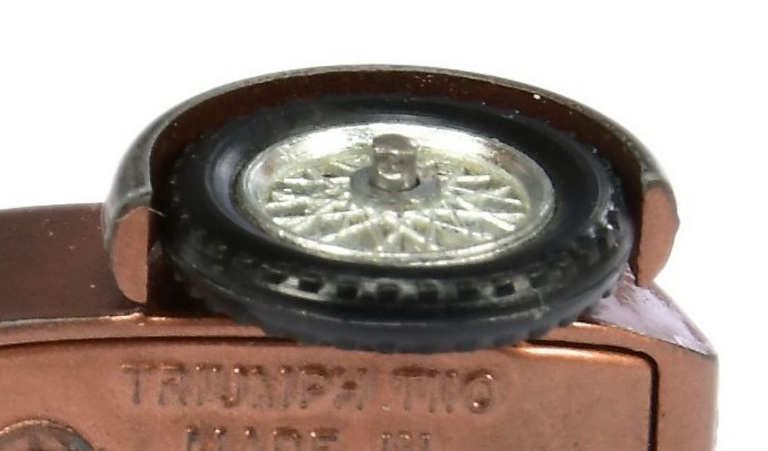

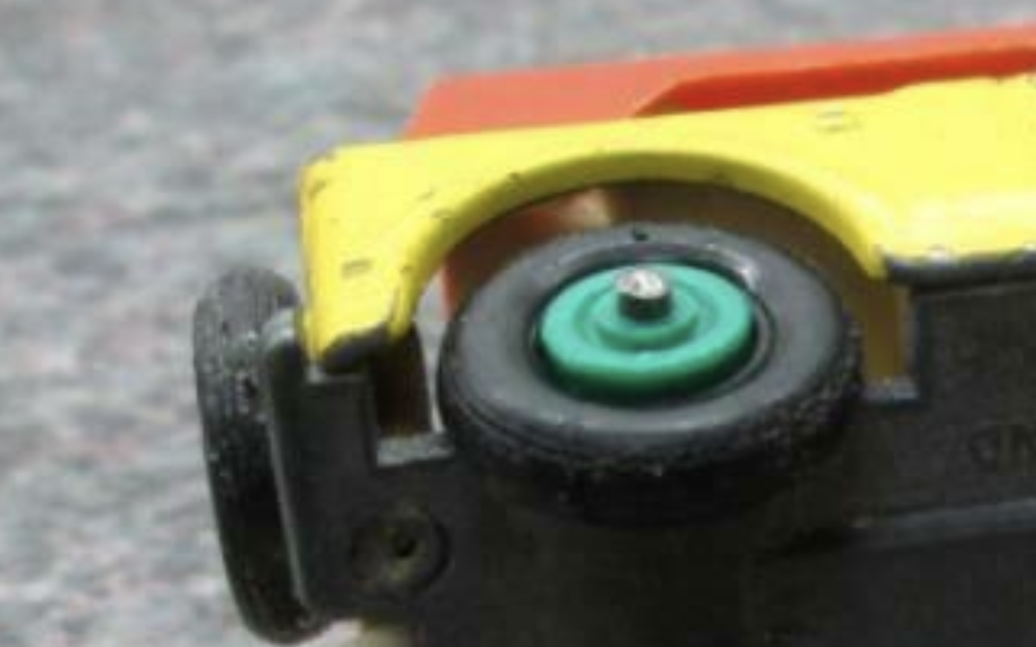

Home made axle-ends are just so different from the Lesney factory axle-ends so if you need to create a rare variation you must remove the 'Flare' at one end of the axle and the smaller flare will always be chosen for manipulation because of less metal to rework.
The picture below is of a model recently discussed here on this forum and if you look at the axle-end it is quite clear to most collectors this axle-end does not look right. With a pair of small pliars the flare has been squashed enough to allow the original wheel to be taken off this axle and a replaacement wheel putting back on. The problem is to put back the flare which will prevent the wheel from falling off the axle and it is virtually immposible to rework this axle-end with the same pliars to bring back the flaring, so some fakers resort to tapping the end of the axle with a pin hammer to try and create a mushroom type of flare but this will cause the axle to bend in the middle if too much force is administered!
For a much better factory finish type of axle the faker can purchase new axles he can cut to length and using the tool supplied will be able to create a nice neat looking axle-end but while this type does look good, it is still not exactly as it would have come from the factory because the key word here is...GOOD. These types of new axles simply do look too good so is a give away to them also being fake items!

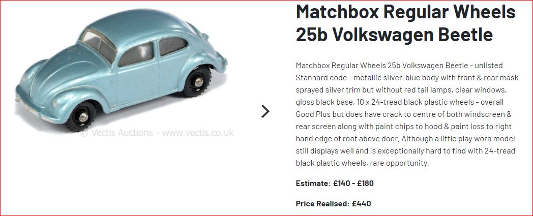

The one Nick shows on his page has the 10x36 bpw but recently Vectis had one came up for auction sporting 24 tread count bpw and clear windows!!
Most definitely a model if where a premium price involved would suggest an in hand inspection warranted and someone parted with over 440gbp

If this is a real variation, it seems very unlikely that there would be different tread counts and different window inserts. They would almost have to be limited to one tread count and one style of window insert due to the fact that it's so rare. The fact they only show up once in a blue moon (excluding the hordes of fakes out there), they shouldn't be spread out over the time line.
