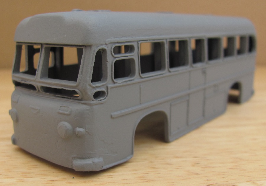

Drilling out the bottom lantern windows cost me three 1.5mm drill bits. They don't like being used as milling bits but it's the only way.
I slipped a bit under the driver's screen and lost part of the beading surround.

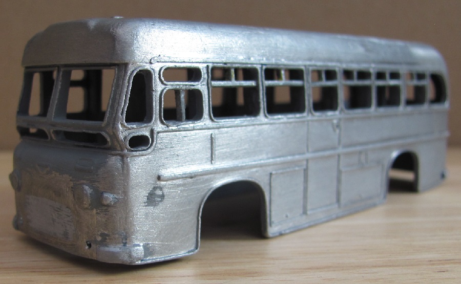

Paint stripped and found a casting flaw on the front nearside quarter. There is also a deep seam down this front quarter but smooth on the other side.
Also, but not casually noticeable is the front panels are unequal drop below the bumper on each side but I won't get involved with that.

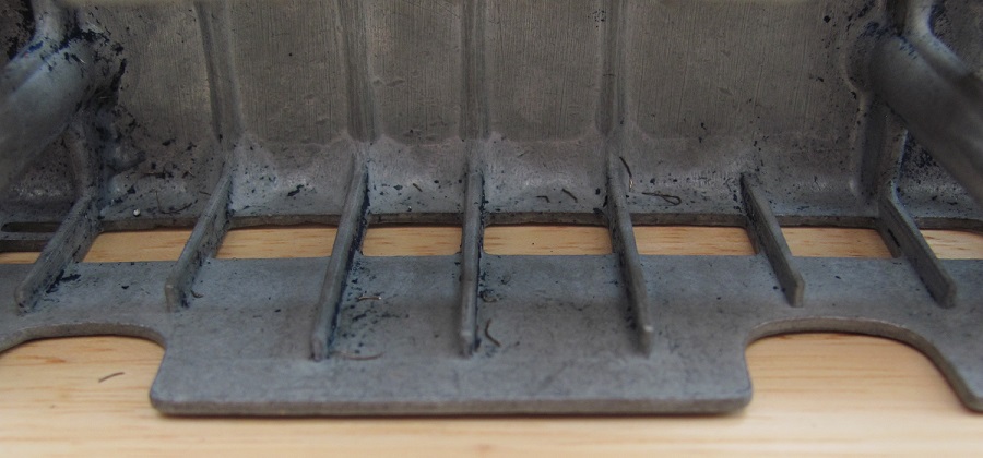

The over thick window pillars are due to strengthening ribs. The centre three each side stop the tinplate base from buckling. I was going to grind these away around the window area to add glazing but I can add glazing between the ribs in a U profile. I'll be adding a plasticard floor to rest on the shorter ribs whick will hold the glazing in situ and also stop light from the wheelarches from entering the interior. I won't be adding seats but it will be so dark inside that it would be a waste of effort.

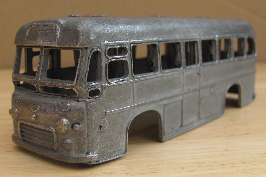

A bit of grinding and filing around the destination blind and grill area and a quick primer coat to show up any problems.
The damaged window beading that I mentioned earlier has been repaired with buttonhole cotton and superglue.

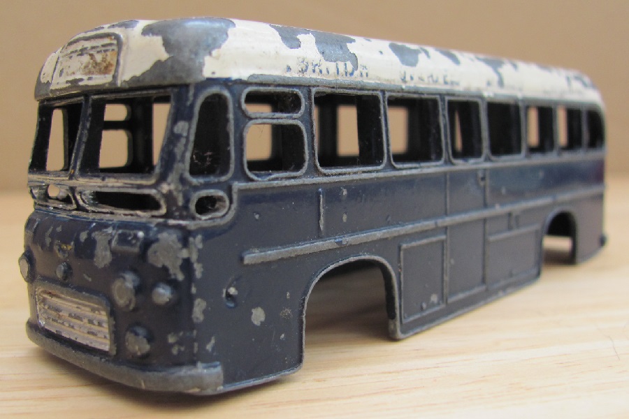

Added sliding window vents and front sliding lower windows .... something that Dinky should have done, or perhaps things weren't as advanced back then.
Got as tight a fit as possible before securing with Syroflex industrial glue. They won't budge.

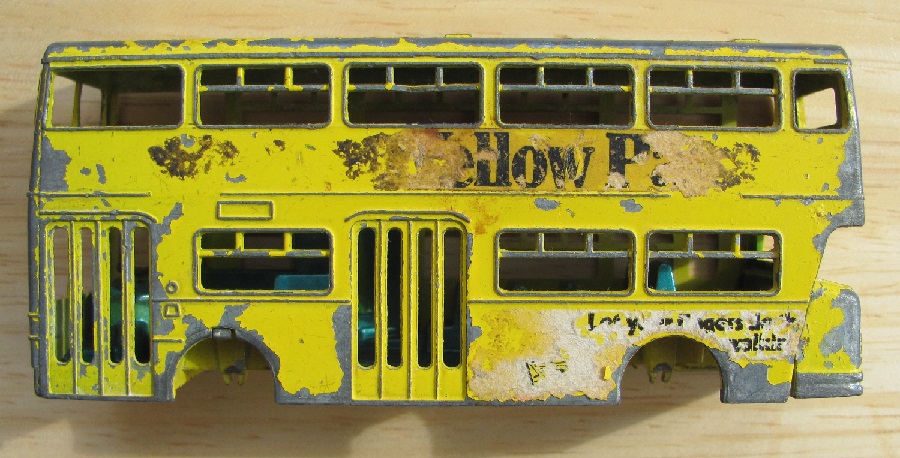

I was going to make these sliding window representations with fine brass bar but it would have been very fiddly. Instead, I set about another tatty old Dinky model.
