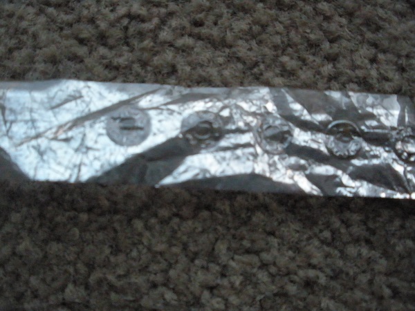

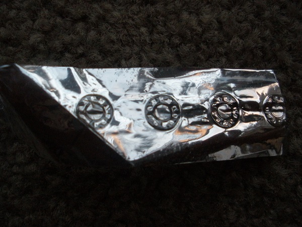

Here is the foil that petethesweet is talking about for the wheels
Cheers Steve
Matchboxkiwi

matchboxkiwi wrote:Here is the foil that petethesweet is talking about for the wheels
Cheers Steve
Matchboxkiwi
On the first glance it may be similar, but its not! The hot foil uses the pattern of the rim to leave the foil on the outstanding surfaces.
Tampoprinting ist just like stamping, although the stamp does not carry the pattern. The pattern is engraved in a smooth steelplate and the paint is aplied on the steelplate. The surface of the steel plate gets wiped, so that there is only paint in the engraving. The tampo picks up the leftover paint and prints it on the object
