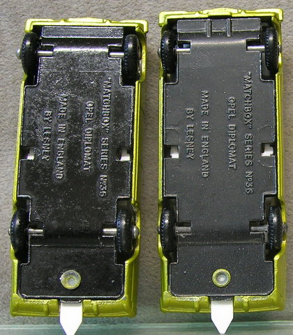

Recently added another early baseplate model this time with the 2mm hinge pin blocks, makes me wonder wether 1mm and 2mm hinge pins were produced very close together or old bases were mixed up maybe.
Re: 36c Opel Diplomat
This is undoubtedly one of the most interesting casting variations on the site since it clearly points towards there having been an earlier body casting (to match up with the front edge of the base).
It would be really interesting to know whether the sea green/turquoise version has this unrecorded body casting.

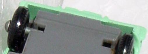

In a lucid moment, I suddenly thought to check my photo archive (culled from here, there, and everywhere). In it, I have found a photograph of the underside of what I believe to be a genuine sea green 36c. As expected, it clearly has the early baseplate casting (moulding?) but, interestingly, has the standard bodyshell.
(Photograph by kind persmission of Alan Wank, aka ToyBoy, http://www.vintagediecasttoys.com/.)
That really is interesting. Logically, the tab would be on the base for a reason. If this is a real plastic Opel (and I don’t doubt Hugh’s judgement on this) it implies there’s an earlier body moulding. I wonder if this might even be metal?Idris wrote:I have found a photograph of the underside of what I believe to be a genuine sea green 36c. As expected, it clearly has the early baseplate casting (moulding?) but, interestingly, has the standard bodyshell.
Glenn, the sea green 36c his not all plastic: it as a plastic base but a metal body.
I should have known that! I think I probably meant that the earlier body isn’t necessarily green.Idris wrote:Glenn, the sea green 36c his not all plastic: it as a plastic base but a metal body.

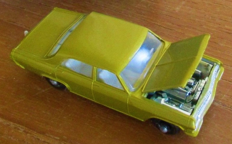

There is a version with the engine in green plastic and with only the top portion in chrome - the chrome is on the top surfaces and extends about 1 mm downwards at the sides of the engine and the other components
I think this version has already been shown by Johnboy some time ago
The photo below has been enhanced to try to show the lower green colour of the engine - the gold body colour is not as intense as it appears in the photo
Sebastian
Sebastian
