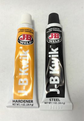

Most modelers and restorers purchase the two part dark grey "steel" epoxy. It works well for most but far from all uses. However, experience has taught me that it is not always the best for all purpose use with diecast model repairs. You can watch and read all the online reviews (most of which are sponsored by JB Weld) and come away with the feeling that their products can fix anything. This is partly true, but you have to use the right product for each repair. You can't purchase the two part "steel" JB Weld and expect it to work on all projects, large and small or different materials.

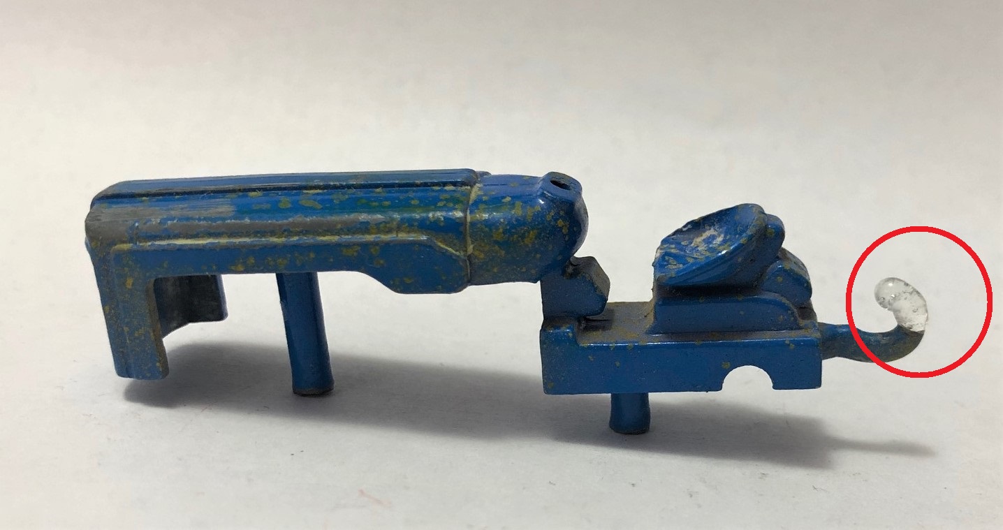

In photo's below you will see a Kingsize Matchbox tractor with half of the tow hitch broken off. There are some good ways to fix this problem: Muggy Weld, UV light cure bonding/welding glue and epoxy. My first impression was to tackle this with JB Weld "steel" epoxy. It failed on two repeated attempts. The epoxy just could not obtain a strong enough bond with the tiny area of initial contact. Since I don't have the UV system and I'm all out of Muggy weld sticks, I had to chose another epoxy. But first I'll mention why I went with JB Weld "steel" on the initial tries.

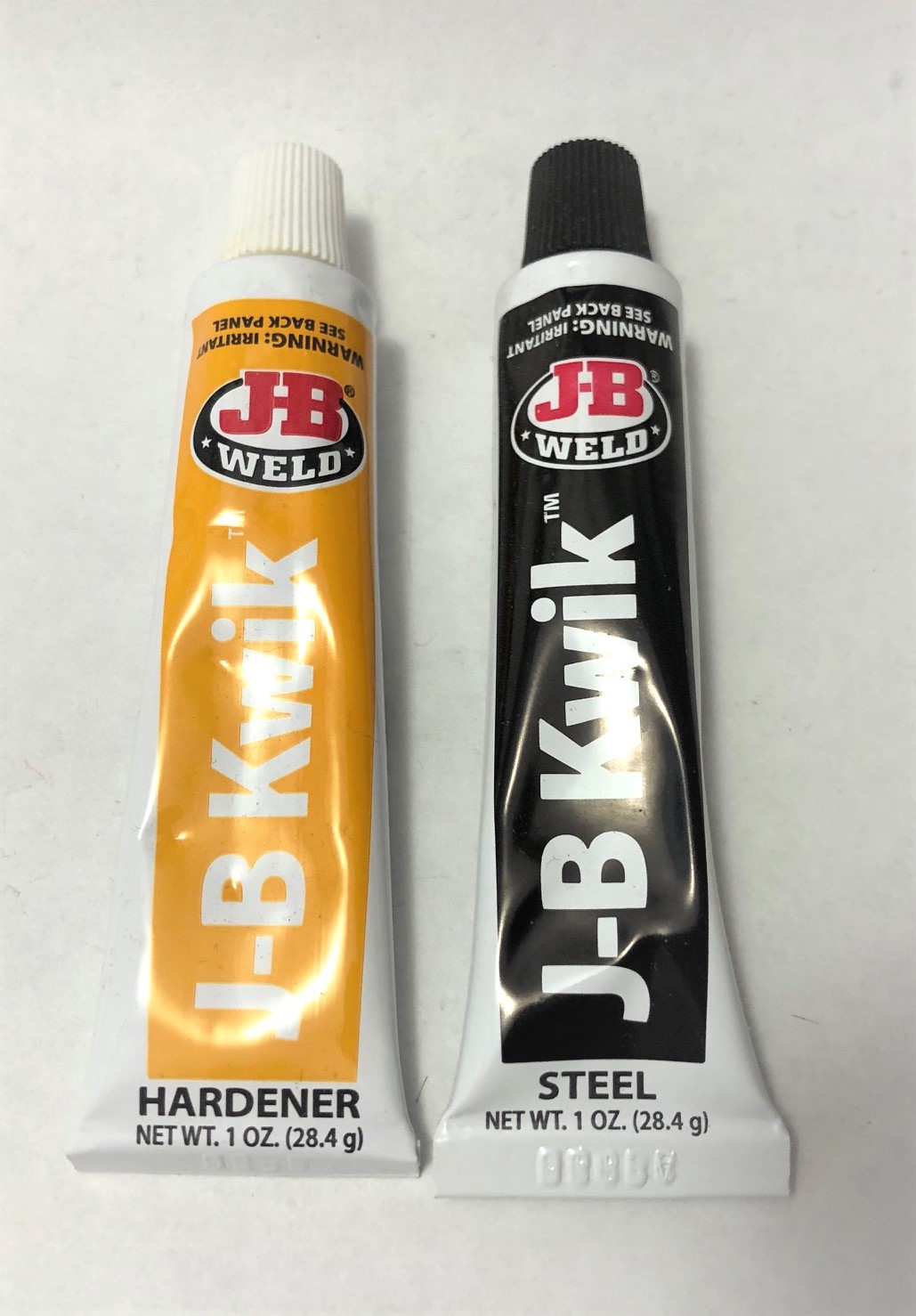

Viscosity, it's got to be built up and curved into the shape of the hook (a challenge in itself). The JB Weld "steel" has a pretty good (thick) viscosity. I wanted to build it up free hand without assistance of a mold, so this was my first choice.
It failed quickly on two attempts. Every time I tried to tool the epoxy, it simply broke away at the contact point of the broken hitch. I concluded that the heavy viscosity made less of a bond at the tiny critical interface. I switched to a lighter viscosity clear epoxy. This made the building up go slower and required multiple applications. It became a side project, every time I mixed up a little clear for a project I used the excess as another application to the tractor hitch. The result was a success. The clear epoxy was well bonded and was well cured due to the longer cure times (since it became a side project). I was able to tool the epoxy without it breaking off at the tiny point where it joined the hitch.

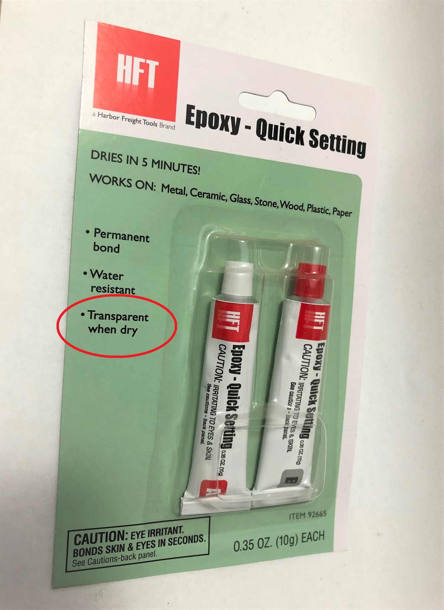

Also shown is the two part clear epoxy I have switched to. I dislike the JB Weld clear in the syringe as (once opened) it has a short shelf life and you have to extrude a fair amount of it for each use. With the smaller individual tubes, I can mix smaller quantities and even add more hardener for a faster set time. The screw caps give a longer shelf life after opening. I usually can use up the entire contents of the tubes over time without issues. Before I close, another way to reform the tow hook is to make a clay mold using a whole tractor's tow hook. Place the broken hook tractor into the mold and fill the open part of the mold with two part epoxy (standard resin molding practices must be followed for proper release). The only other tractor I had has the later issue "Square hook" so I could not do this and had to free hand the build up.
