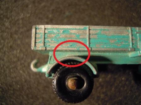

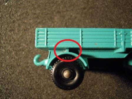

There are some unlisted variations. Above rear mudguard:
a) without brace
b) with brace

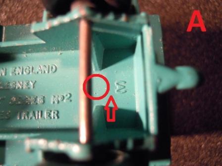

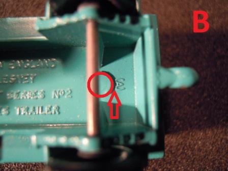

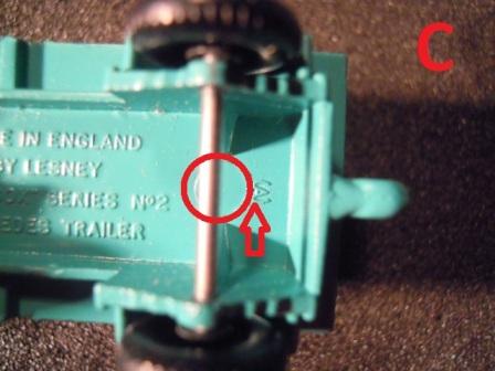

base plate:
a) small ejector ring, large gap between ejector ring and (A), larger triangular brace by hook
b) small ejector ring, small gap between ejector ring and (A), small triangular brace by hook
c) large ejector ring, small gap between ejector ring and (A), small triangular brace by hook

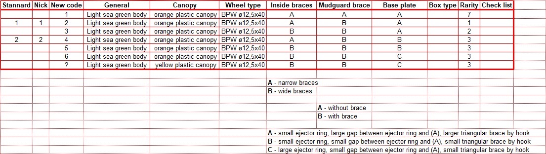

I am enclosing a proposal of a new 2d list. I have added three variations: mudguard brace, base plate and canopy. I am not sure, if the yellow canopy could be a new code. I am also not sure if there is a variation without mudguard brace and the wide inside braces and the variation with C-base plate and the narrow inside braces.
Please comments.

After 5 years surching finally found one without the brace. Are these hard to find, never thought it that it would be so difficult.
DrJeep
Posts: 1094
Re: 2d Mercedes Trailer
Post by DrJeep »
Pierkemimi wrote:After 5 years surching finally found one without the brace. Are these hard to find, never thought it that it would be so difficult.
I agree - they are really hard to find.
