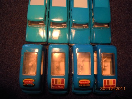

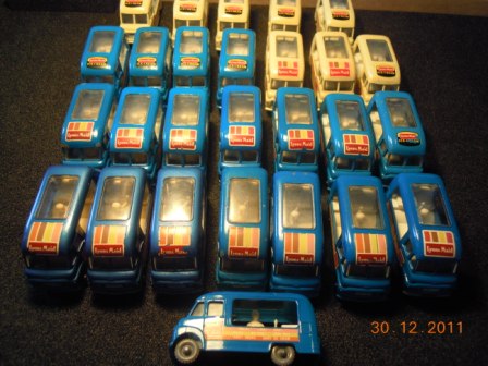

There are not only variation in blue colour by 47b Commer Ice Cream Van,
Diecast
Posts: 1571
Re: 47b Commer Ice Cream Van
Post by Diecast »

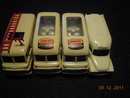

but also white variation:
a) cream (or dark cream)
b) light cream (or off white)

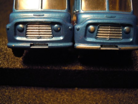

There is one unlisted silver trim variation:
a) silver trim to grille, bumper and headlights
b) silver trim to grille
Diecast
Posts: 1571
Post by Diecast »
There are a lot of variations.
Diecast wrote:There is one unlisted silver trim variation:
I see that you've shown this on the early, metallic blue version. Does this also occur on the non-metallic blue or cream version, Antonin?
Diecast
Posts: 1571
Post by Diecast »
As I have checked my models, I have found one blue model (with long stripes) with a similar trim. But it has a small trace of the silver trim. As I have checked the metallic blue model once more, it has also a small trace of the silver trim. The trace does not seem as the wear out. I think that the mask for the trim was at some time congested.
Diecast wrote:I think that the mask for the trim was at some time congested.
That would make sense. (With the exception of the 47a Trojan Van, I cannot think of any other model that gained additional trim during its production run.)

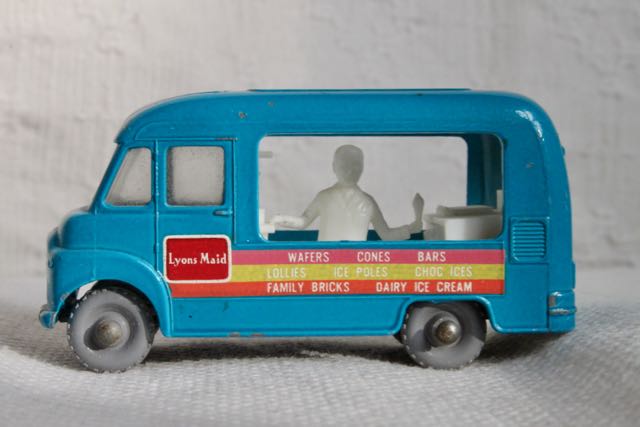

I've been asked to put this here for further reference. It´s my own Ice-cream van, apparently unlisted. It´s been suggested as a 10a, as it is: Blue - 10x24 - GPW - Short stripes - Taller striped - Snap-in - Shorter man (with head beneath the window-frame - Brace behind the driver seat. Thank you Yellowfoden, for helping me with this.
IMG_6389 (1).jpg (12.36 KiB) Viewed 3148 times
IMG_6391 (1).jpg (63.67 KiB) Viewed 3148 times
IMG_6390 (1).jpg (44.38 KiB) Viewed 3148 times
IMG_6392 (1).jpg (42.1 KiB) Viewed 3148 times
