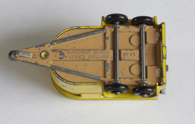

I have checked all my 43c Pony Trailer and I have no one model with the ridge and just with the raised numberplate at the rear. I can mention only a small unlisted variations:

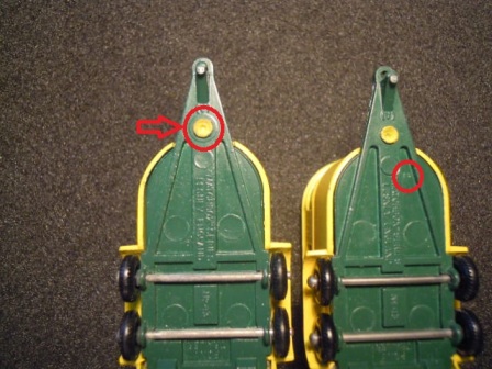

a) base plate without reinforcement ring for the rivet
b) base plate with a reinforcement ring for the rivet

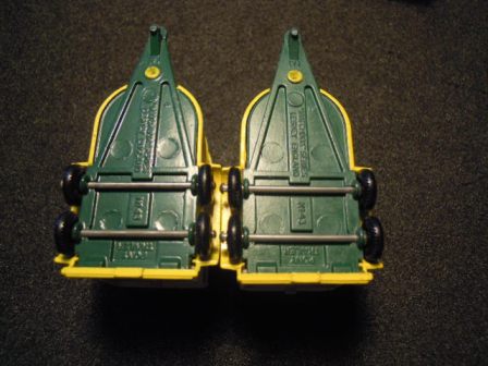

I have the tan base plate with number 1, 2, 4 (no 3), the green base plate without any number, with 2 and 4. Has anybody the number 3?

the base plate could be glossy or matt

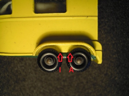

under the left mudguard by models with the ringe could be "I" "A"

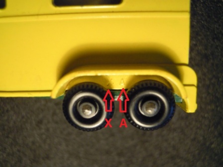

or under the left mudguard by models with the ringe could be "X" "A"

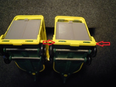

by the very late models is the raised section without "step"

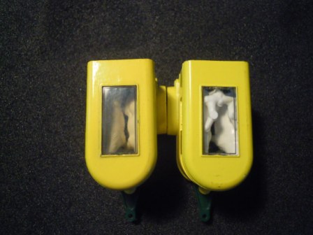

the windows could be smoke or clear

Diecast wrote:I have the tan base plate with number 1, 2, 4 (no 3), the green base plate without any number, with 2 and 4. Has anybody the number 3?
I don't have the number 3 either, but I have the tan base without any number.
