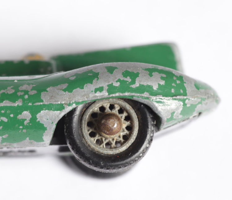

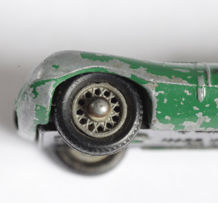

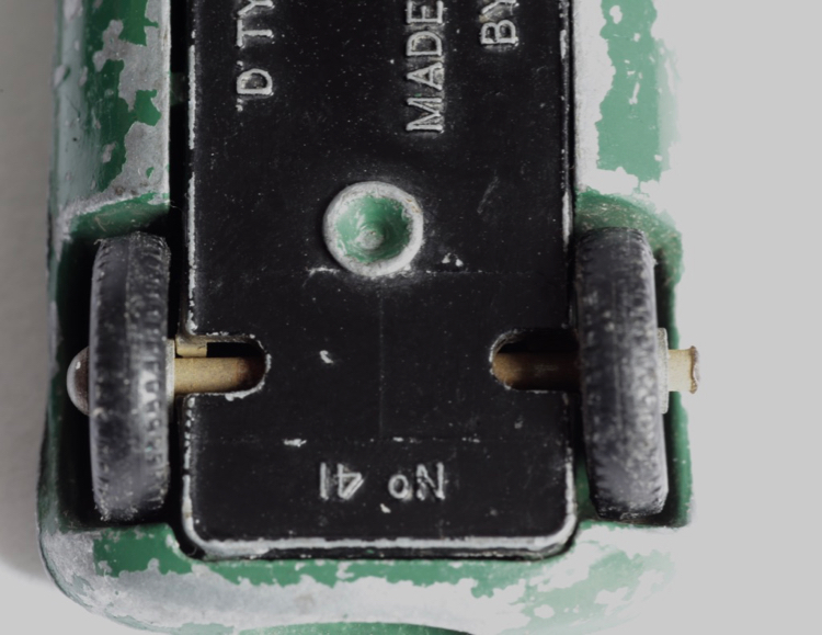

Here are the axles from my 41b. The front - which has the three-way crimp on the other side - has a notably brighter section and is perhaps it little more domed
front axle - opposite end has 3-way crimp
The rear is more corroded and has a flatter top section.
rear
rear
John might be onto something with the axle length - this one is about 2 mm longer than my other wire-wheeled 41b.
axle length
axle length

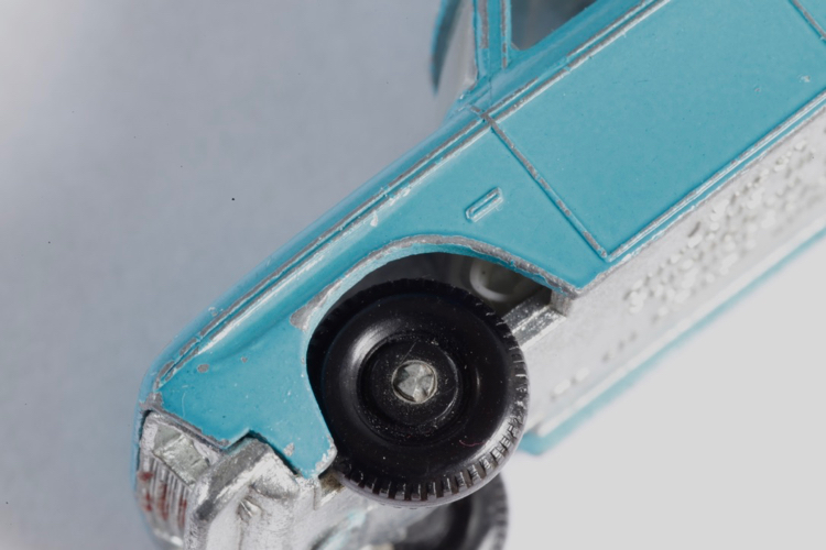

Here's another, on a 42b Studebaker. It's Nick's code 1, in the darker blue with the sliding roof in the same colour (it looks lighter in this picture because I exposed it to show the axle).
yellowfoden
Posts: 626
Location: Aust
Re: Three-way Axle Crimps
Post by yellowfoden »
Very nice Glenn.
This is the latest we have seen so far time wise. It was released in January 1965 ( I can’t remember the day :) ) in Europe but had been released in November 1964 in USA. So the chances of finding a code1 with three way crimp in the UK would be somewhat lessened if the first off the assembly line went to the states, so a good find here.
Judging by the nice crisp condition of the wheel tread it looks to have seen little play miles but hub/boss is quite scored as though the crimp is quite aggressive. It also looks to have a flat end as apposed to slightly round. What does it look like from the side view and how does it compare to previous model photos please?
I take it is just the one wheel.
I have added it to the list on page 6 of this thread.
Bert
