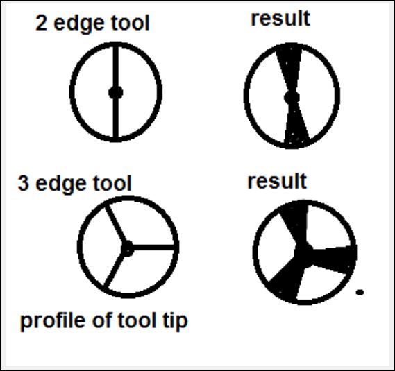

Since my post above earlier today, on the drive to work I thought about this some more. I decided to try and mimic a rotating tool pressing against a stationary spindle eg axle.
I tried it with wood being a little less forgiving and trying something for the first time.
With the tool tight in the chuck and spinning, as the tool cutting edge engaged the spindle the work piece (the spindle to represent axle) started to spin. As pressure was applied to the spindle from what would be the dome end there was sufficient chatter to cut the shape I have drawn in black.
The tool effectively had two edges cutting into the timber and with centre pin keeping it true.
As I applied more pressure to the spindle the tool then acted like a cutter. When I backed off I was left with what I have drawn.
If this tool and was curved I am sure I could create a rounded end.
This is effectively what Hugh is suggesting as mode 2 and also what Kurt touched on with two stage operation.
So a tool with three blades I think could create the pattern we see on three way examples shown dependent on dome pressure and a second or two and could be the tool that created the variety of normal rounded ends with the dome gripped and time applied when it was operating correctly.
Bert

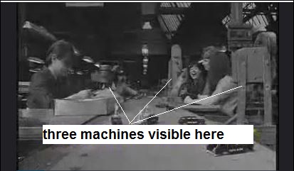

Glenn, thanks for reminder of the Dinky clip, there are about 8 scenes where machines are shown. At one point three different devices are seen. Screen shot attached.
In films I have seen of Lesney there were also similar machines a various points along the assembly lines and the still shot of the female working on the 13c taken from this clip.
