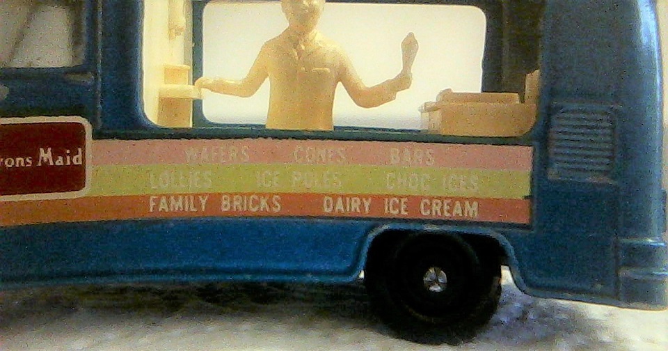

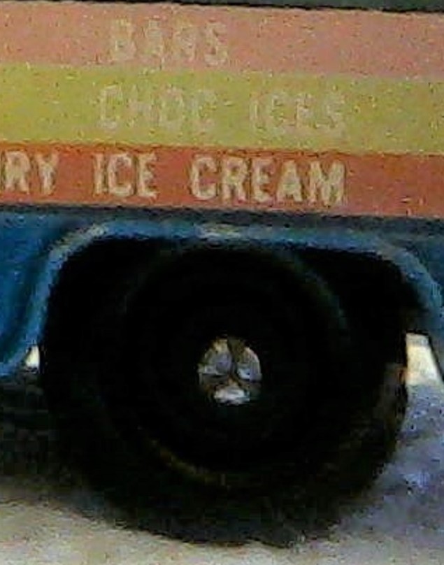

To save you having to go all the way through the posting in the link above I have given a quick summary and photos belowIdris wrote:...and one has also just been found on a 47b.
This one is Nick Jones code 5 - sorry about the quality/distortion of the photos - curvature of the van base is caused by a magnifying glass - colour is not metallic blue just the standard solid blue lightened by the use of photo to bring out the detail on the axle end
Sebastian
- WIN_20190118_12_50_22_Pro (2).jpg (202.04 KiB) Viewed 12501 times
- WIN_20190118_12_50_22_Pro lightened with photo 75% size multiplied by 2 cropped.jpg (105.2 KiB) Viewed 12501 times
