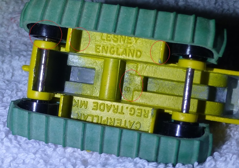

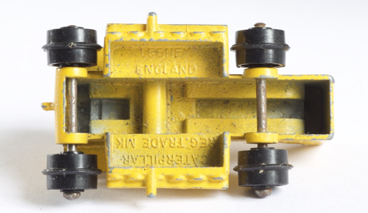

Here's one that's missing from Nick's codes for the 8c. It has black plastic rollers, the partial number, but no triangular braces. It's a variation that's listed for the 18c, and as they both use the same casting and rollers it's not a surprise that this variation is also found on the 8c.

Hi Glenn , Hugh and all,Idris wrote:The NAMC’s “Catalog of all Series Matchbox Models” (second edition) lists two models missing from Nick's listing: variation 8-3C has SPR and carries model no. 18, whilst variation 8-3G has BPR and carries model no. 8. Can any Member confirm the existence of either (or both) of these models?,
Thanks for the addition of this model to this thread Glenn.
In my Stannard catalogue I had noted I had this model but spent a bit of time this weekend trying to find it.
I am able to add a second example of your model variation with black plastic rollers, NO braces and with the partial number 8 visible. Not that it needs a second one given as you say they exist without blade as per 18c. With respect to the question from Hugh above I wonder if this is the bpr 8 that NAMC is referring to!!

Photos attached to show bpr, brace area and partial numbering with just the 8 nice and clear.
Suggest this could be put at NJ code 6a and lines up with the 18c code 15

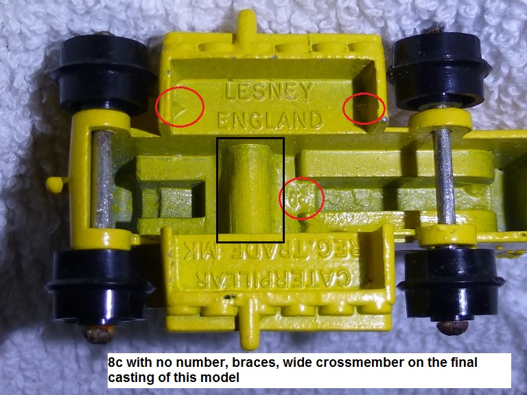

While I had these out I snapped a photo of the wider cross-member which Nick mentions on the 18c but it is not mentioned in the 8c. This shows just how worn this mould was becoming at the end of its life. This is the last code for this model.

Thanks, Bert. That one is in amazing condition too, and the tracks look like they're new!
- I think the number 18 mould was modified to give the partial number that we've both shown. I say this because of the distance between the remains of the N and the 8.
- I think the number 8 mould had the number deleted completely and was given the wider cross member.
In turn, I wonder whether the triangular braces were only added to the old number 8 mould. Does anyone have the triangular braces without the wider cross-member?
