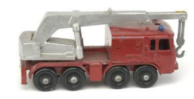

I've had a proper look at the hook on the box illustration - as well as having twin ropes, it's much shorter than the production hook, which perhaps confirms it was from the 30b, and suggests it was held in place by a rivet. There's an intriguing prepro (?) on Nick's site in the price guide. This one seems to have the grey hook from the 30b, as well as casting differences on the jib and a different cab - where is it now?
Screen Shot 2018-08-06 at 14.06.12.png (254.73 KiB) Viewed 7875 times

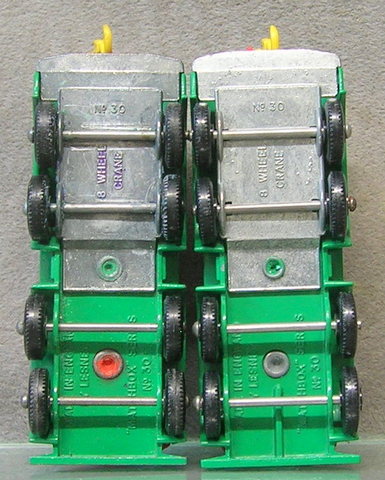

kerbside
Re: 30c Faun 8-Wheeled Crane
Post by kerbside »
As you can see my one with-out the rear brace has got the wider wheels than the other one.
DrJeep
Posts: 1094
Post by DrJeep »
Interesting, and you’ve made me measure mine. This is what I found:
Braceless (2) 3.1 mm and 3.3 mm
Orange rivet (5) 2x 3.1 mm, 2x 3.2 mm, 1x 3.3 mm
Unpainted rivet (1) 3.2 mm
Tow guide (2) 2x 3.4 mm
I’d suggest that there was a mix of narrow wheels at the start of production, with much wider wheels at the end.
