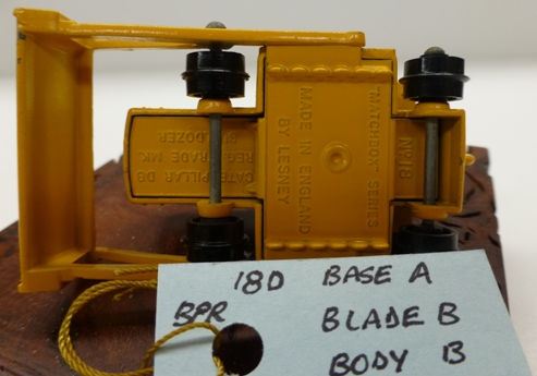

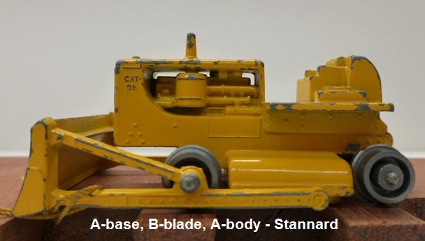

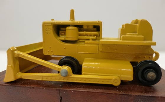

Here you go Dick,
These two of mine do not feature in M.J.Stannard or in Nicks codes.
I have a silver plastic roller SPR with Base A no hole, Blade B with brace and Body A square inside rear.
Attached are images showing base, the blade and the rear inside view
Please note Dan has shown this SPR variation with photo in the past.

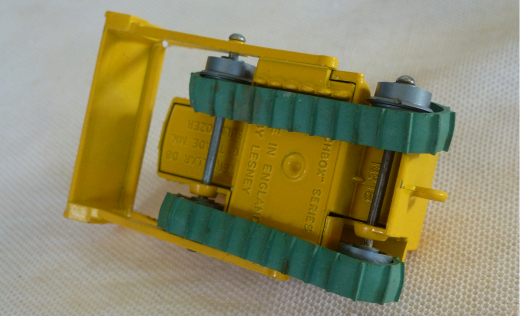

The second is BPR with Base A no hole, Blade B with brace and Body B rounded inside rear and is open under muffler/silencer and open in front engine and large exhaust pipe.
It has low mileage owing to lack of tracks :)
Bert
2.18d SPR unlisted Stannard and Nick as at 26 Jan 2017.JPG (65.35 KiB) Viewed 2915 times
3.18d unlistedStannard and Nick as at 26 Jan 2017.JPG (110.53 KiB) Viewed 2915 times
4.18d A-base. B-blade. B-body unlisted 26Jan'17.JPG (107.44 KiB) Viewed 2915 times

As luck would have it Bert, the only two uncoded variations I have are ALMOST the same as yours. Mine with Silver rollers and the later braced blade has the Type B body with large exhaust stack and the lower round edged ridge on the inside at the rear. Yours has the type A body which is square edged on the inside at the rear. Because of that, I cannot confirm your 'new' code, only add mine as a possible "New" Nick Code also.
Your black plastic roller version that has the A base, B braced blade, and also has the B body with round lower edge and large stack I can confirm because we have one that is exactly the same in our collection. It was penciled into my Stannard's Bible in Sept. of 2013, not that long ago. kwakers

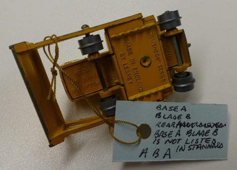

Here I have an 18d Dozer with Silver Rollers
Blade Brace
No Hole Base
Square Rear Brace.
This is the same as Yellowfoden posted over a year ago.
Cheers Red.
