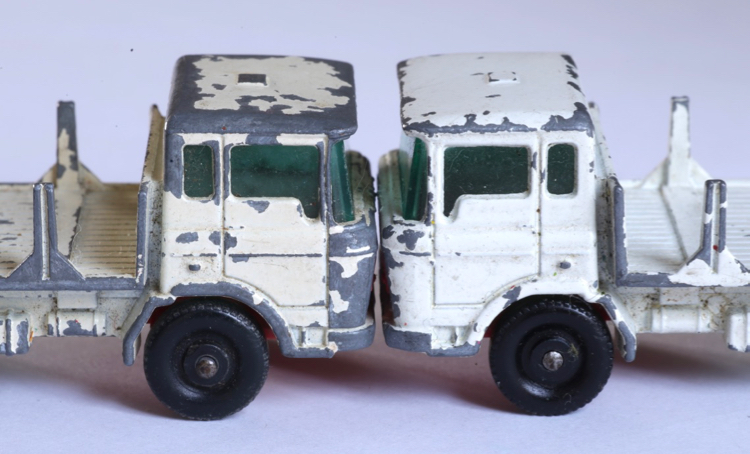

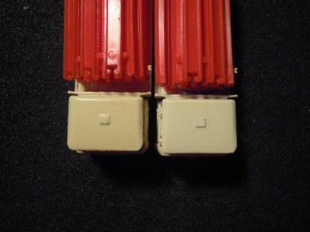

There are a couple of casting variations on the 58c DAF. Most 58cs have a gentle convex curve at the back of their cab, but I have one that has a straight cab wall. The same 58c has thinner supports on the vertical wall of the bed - measure at the bottom, they're around 0.9 mm compared to 1.3 mm on later models. This model has no tow guide and a chiselled rivet holding the glazing in place. It's mould 1 (the number is on the base just behind the cab). I have two others without tow guides: one has an unchiselled rivet and the other has either a very short rivet or no rivet at all. Both have the curved cab wall and thick bed wall supports.
- straight cab wall on right, curved on left
- IMG_5610.jpg (358.84 KiB) Viewed 7449 times
- thin bed wall supports on left
- IMG_5614.jpg (326.71 KiB) Viewed 7449 times

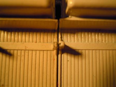

There are some more unlisted variations. Slightly different posts on the side of the load bed.
- DSCN6323.JPG (20.75 KiB) Viewed 7424 times

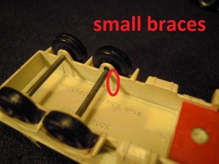

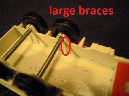

Re: 58c DAF Girder Truck
different axle braces:
a) small braces
b) large braces
a) small braces
b) large braces

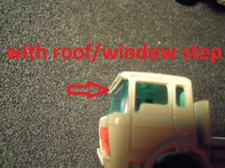

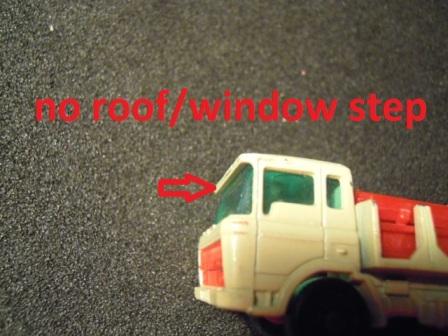

a) with roof/window step
b) no roof/window step
- DSCN6328.JPG (32.07 KiB) Viewed 7416 times
- DSCN6327.JPG (30.1 KiB) Viewed 7416 times

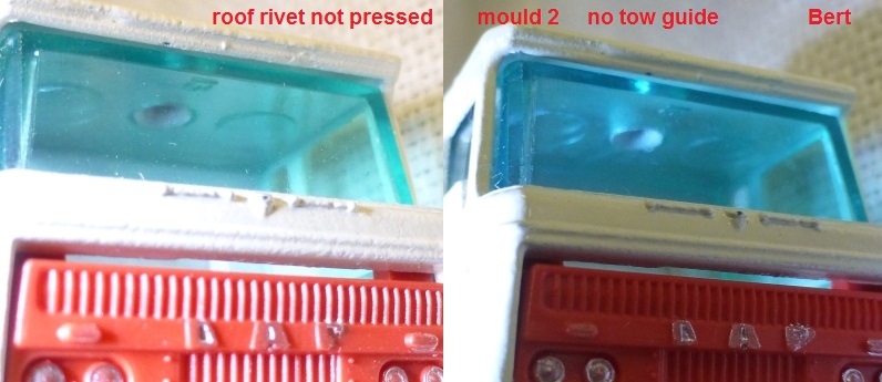

My records indicate I have two un-pressed roof rivets but 1 is hiding from me at present.
The 58c with the roof rivet that I can show has not been pressed and for some reason has not allowed the window plastic to sit home; this in turn has not allowed the grille/base plate to take its correct position.
While it may be an oops it counts in my collection because of the roof rivet type finish.
An added touch is the silver trim to the 4 head lights, indicator lights and the DAF letters. Under magnification it looks like spray or possibly sponge applied, but not brush applied.
How it was done and when it was done is unknown but it has been done very neatly and looks very cool.
In the images by directing some light into the window plastic you can see the full shape of the rivet.
Note by adding some led light to pic on the right I have given myself a new window colour.

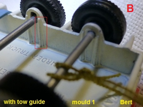

My image labelled B is to show the axle support large taller brace on mould 1 to show that both moulds were modified. Antonin has shown same modification to mould 2.
I expect all these larger braces to coincide with models having tow guides.

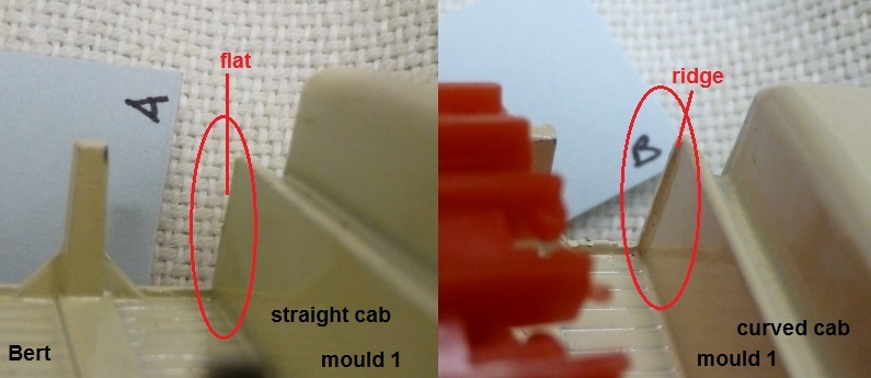

The variation that has my attention is where mould 1 labelled A has a straight cab and model labelled B which is about the last code also mould 1 has a curved cab. Each of my mould 2 has curved cab.
It was when I put a straight edge to the back of the cabs did I notice the vertical board directly behind cab can have smooth or ridged edges and this could be the same as drjeep mentions above with image number 5614.
It would appear this mould was modified to become a curved back on the cab like mould 2. I have taken the photo from the other direction to that taken by Glenn.
Refer to image titled “straight and curved cabs.”
Does anyone have the model with straight cab with mould 2 please?

- Un-pressed roof rivet
- 1 unpressed roof rivet.jpg (95.75 KiB) Viewed 7363 times
- Late axle support braces
- 2 late axle support braces.JPG (55.71 KiB) Viewed 7363 times
- Straight and curved cab with SAME mould number
- 3 straight and curved cab.jpg (82.26 KiB) Viewed 7363 times
